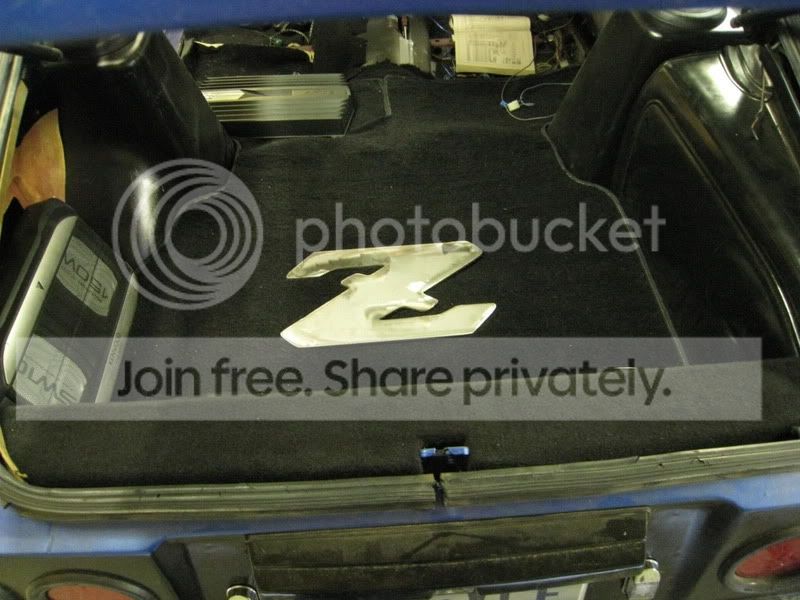

UPDATE!!! I'm putting the stereo in, the amp, sub, and rear 6x9's are in. I made the box myself, didn't see the point in spending $200 for one when I have some 3/4" hd particle board lying around. Here are some pics.
[IMG][/IMG]
[IMG][/IMG]
It's coming along quite nicely.
