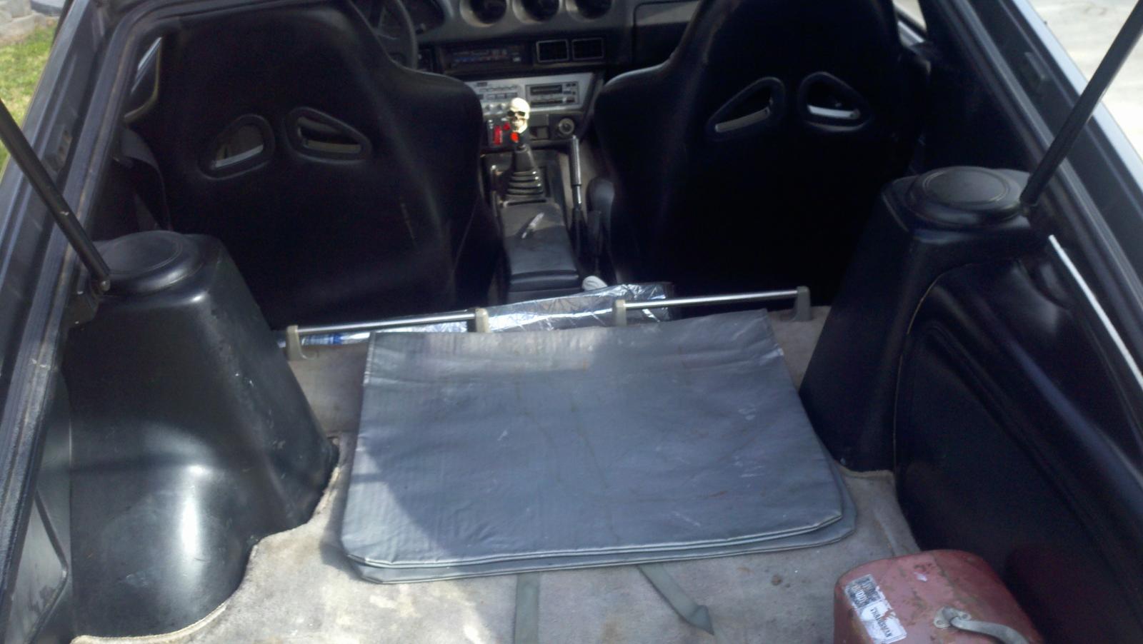

Attached Thumbnails Intro/ silvers build-2011-12-30_13-10-46_723.jpg   Intro/ silvers build-2011-12-30_13-17-00_966.jpg   Intro/ silvers build-2011-12-30_13-17-27_443_edit0.jpg   Intro/ silvers build-2011-12-30_13-17-42_880.jpg   Intro/ silvers build-2011-12-30_13-17-54_884.jpg

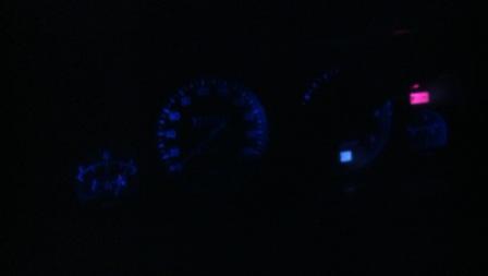

and YES I know the lights are left over 90's fast and furious fad but ehhh I kinda like them. I'll leave them on for just that reason lol plus when it gets up to full par it'd be a cool addition for car shows.

What kinda seats are those?

They say BOMZ racing on the head rest. Pretty comfortable seat only thing is that the top shoulder pad rubs the door jam makes a little bit of noise, but hopefully after being mounted correctly that will go away.

I got bombz seats as well. They are a Chinese off shoot of apc racing seats. Exactly the same manufacturing plant. Super comfy and I love them. I can road trip those seats for 16 hours and still want to drive. I think I have the same steering wheel but have never got it mounted. Having to make my own adapter has slowed me up some lol.

Haha and I actually like the blue streetglow. It's over the top but so awesome at the same time. I may just do that to mine, I already have the big body kit to go with it, may as well hide some lights behind those side skirts

Thanks I’m lovin it!! Yea im not to into the under glow but it is cool looking sitting in the driveway at night my son thinks we now have a fast n furious car and wants to race everyone we see at a stop light thinks it’s the fastest car in the world with them lights lol

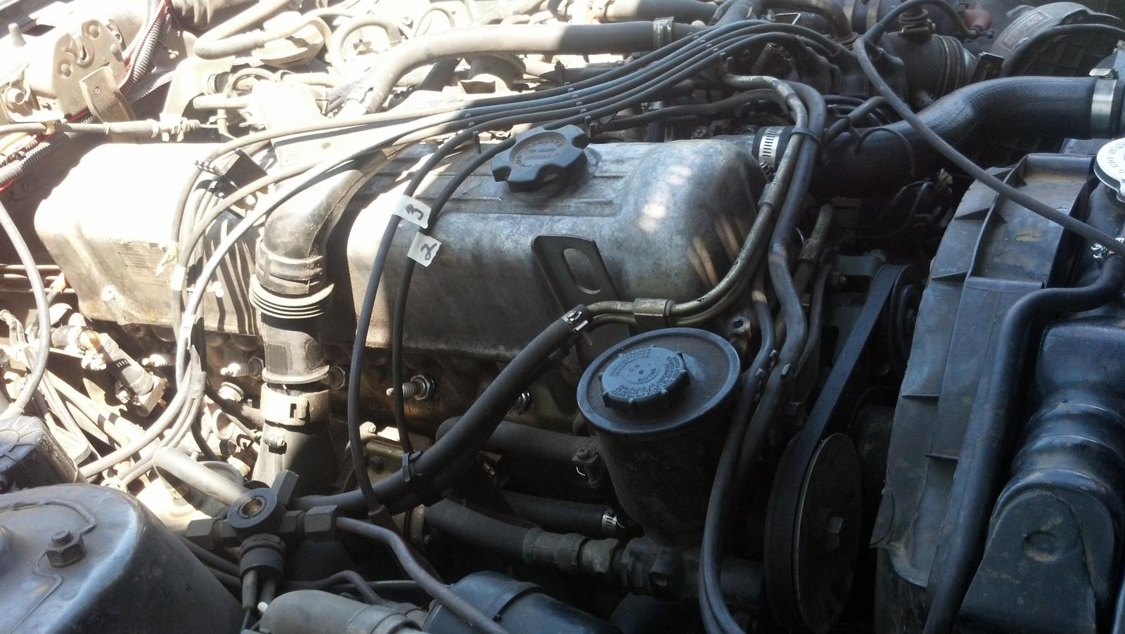

Ok guys finally getting the opportunity to get on the computer and post my progress. So the start I replaced the whole exhaust with the stock one from the parts car it got extremely loud my first week off driving it found that it totally burned through the Y just after the exhaust manifold. Then I did a Full Tune-up. Plugs, wires, cap, rotor, adjusted the valves and set timing back to 8’ found it at all most 18’ advanced?? Fresh clutch, full bleed out all new fluid and adjusted properly. New front breaks full bleed out all the way around. Then I went on to order up a new radiator all aluminum welded 3 rows, sweet find 175 bux shipping included. Swapped out the stock air box with the o’reillys build your on set-up tubing’s with the K&N cone filter.
I’ve also dewebed the extra intake manifold and powdered it in wrinkle black semi-textured powder, and powdered one of the extra valve cover just to see how it would turn out and am running that. I have the 2nd extra valve cover at my old shop being done to match the color theme the p.o had already started along with the thermostat housing, water output fuel rail vac lines and mic other pieces. Once that’s all done my plan is to do a full rebuild on that side intake exhaust gaskets, injectors seals ect ect, prolly just go ahead and go all the way to the head gasket since ill already have it torn down that far.

hey that intake manifold. Where do you get it? ive seen them alot on modded Z's or do you just trim it?

It's not aftermarket, just "de-webbed". All you do is cut out the metal in-between the runners. May as well port the manifold while you're at it too.

Its really easy I just drilled lots of holes all the way around tapped it out then used a rotary bur tip on a dreamal to take off the high spots then filed it all smooth took about 4-5 hrs to complete. Still need to port and considering opening the throat for a 60mm 240 TB for future performance , but need more info on that upgrade.
