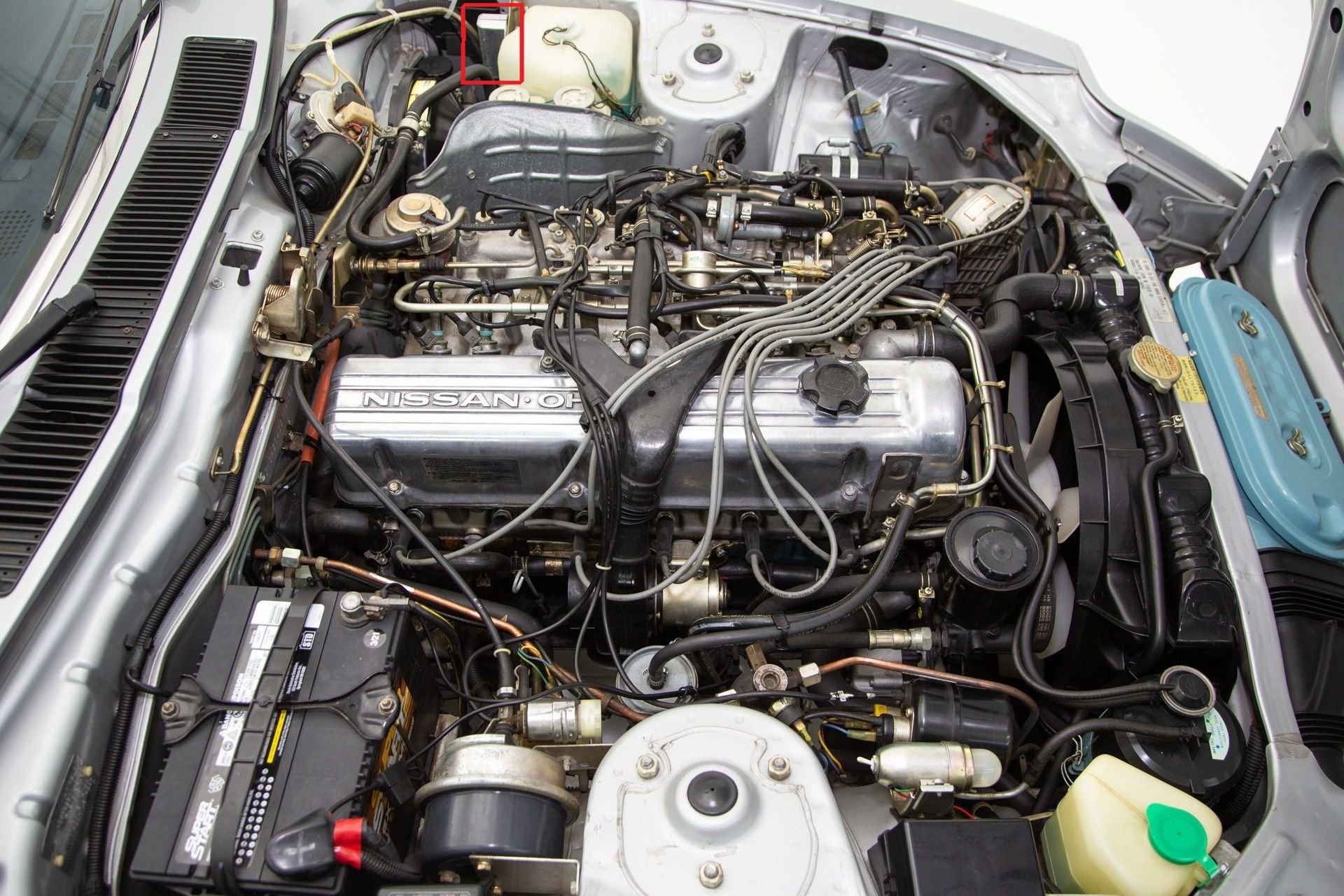

1982 cars should not have a dropping resistor, but odd things happen when cars are built. Verify you do or don't have the dropping resistor. If you do, clean the connector on the resistor. The resistor would be located on the drivers side fender in front of the master cylinder beside/under the washer tank. If you don't have the resistor you can only use the 1982 and 1983 ECU.
You can see the dropping resistor here circled in red
