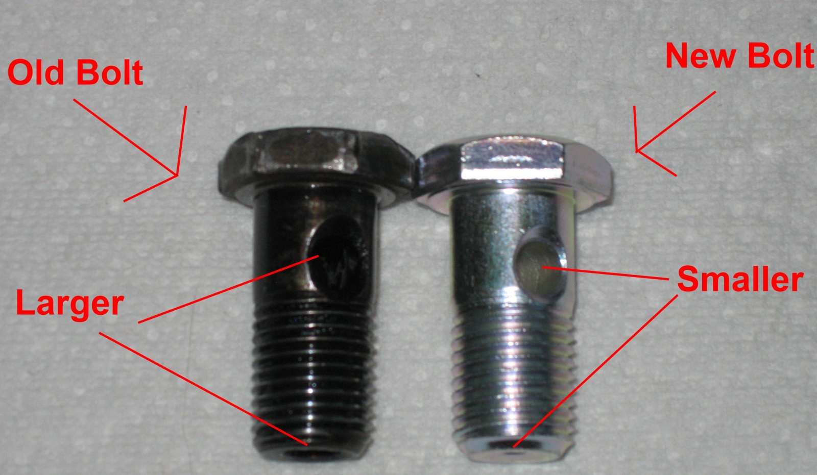

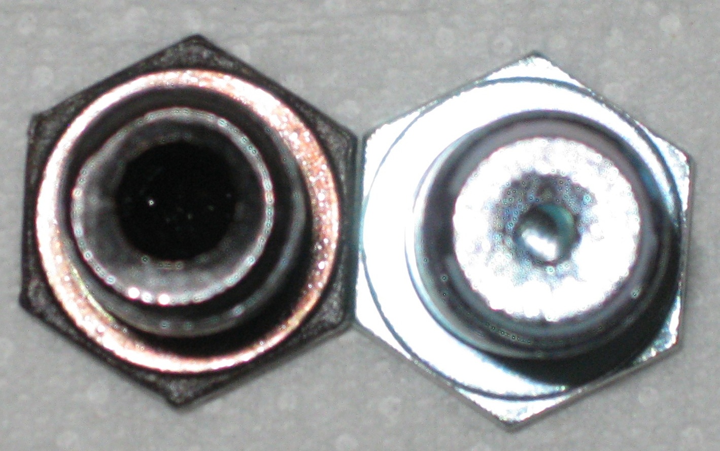

Also, I got my new banjo bolt in today, and there is a definite size difference. So hopefully this fixes the oil leak problem, however before installing it I want you to verify it is right for me. The old bolt has much larger ports, particularly on the bottom. Will this new one allow enough oil to flow?
Sorry if its crap quality, my good camera broke and this one doesn't like close ups apparently.

Is that new banjo bolt from Nissan? If so, I would have no worries at all. The oil feed line is pressurized... so it will get oil.

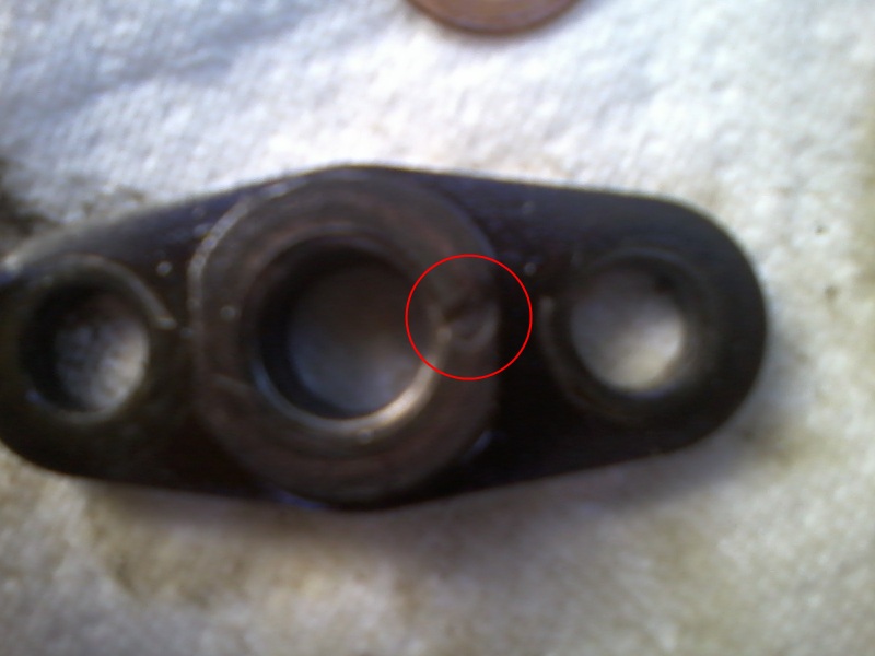

Another update - The only thing I was able to get done after work today was install the new Banjo Bolt and washers from Nissan. No luck, it is still leaking even when torqued down tight. Here are some pictures, oil is pooling on top of this part here:
(Sorry for the size and quality, it was dark :\)
Which leads me to believe it's leaking out underneath the bottom washer. The top part seemed completely dry. Perhaps that part got warped? Is it pretty easily replaceable or removable? (I couldn't find the part name, didn't see it in my quick search of the FSM and Nissan4u is down). Looked like it was just two bolts or so to pull it off of there..
Edit: The Spacer-Oil Tube? And I assume if I replace that I'd have to replace the Gasket-Connector as well. (Parts 8 and 13) http://nissan4u.com/parts/280zx/us_s...turbo_charger/

Found the source of the leak, just where I suspected. Looks like it got damaged somehow.

Yerp... that would do it. I'm surprised you didn't notice that during the 10 times you removed & installed the banjo bolt.
Hahaha I am too but it was towards the back and I didn't really think about it. Plus its usually dark when I work on my car!
Excuses aside I am just glad that's figured out! On to the next thing, at least I can stop worrying about smoke now
