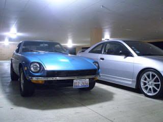

hmmm.... depending on tmepurature, i can spin the top of first under just boost (no launching) how hard i hit second i can make the gear almost useless, the rest if just holding on and keeping the car under control because the worn out bushings, open diff, and tiney sway bars the rear end starts to sway on you.
basically, its fawking awsome, as long as i keep it running good. these stupid old harnesses and connectors make bad connection. and my original soldering job didnt last very long had to re-do it.

^^^ You should get that car dyno'd.
Old Jan 4, 2008 | 07:21 AM
<<< ya, I want to know what that Honda is putting down!
Old Jan 4, 2008 | 11:00 AM
well, if dyno runs werent expensive i would. lol. i guess they arent that bad for a couple pulls. but still. id rather wait. i think im going to try to find the 240sx tranny ive been talking about getting. anything thats 5speed and farily straight swap, this 4spd thing is killing me!!!!!! it just robs everything from this car. and id like to stick an R200 up there, but id need some half shafts. and does anyone know if the 260Z shares the same stub axles as teh 280Z or with the 240Z cause i know they are different for some reason, i think the bolt pattern is a little off or somthing and the amount of splines in it to or something....
Old Jan 4, 2008 | 11:27 AM
$50-$80??? Bring some friends and then they'd prolly even discount it!
Yeah... keep waiting... then you'll never have to prove it makes 170hp. They do dyno pulls in 3rd or 4th, so your 5th gear cop out won't save you on that one.
