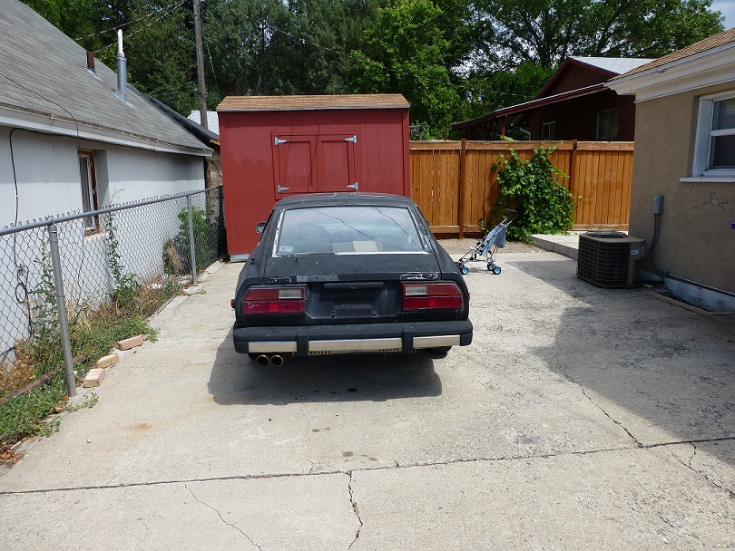

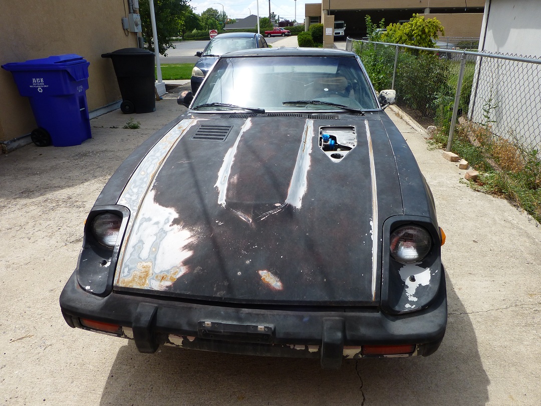

Nismo is right, the car is in pretty bad shape. I was barely able to get it home, and that was just 31 miles. The brakes are gone on one side, so when you step on the brakes, the car pulls (quite strongly) to the left.
The interior is completely trashed (shame, because it was the original leather), though I might try doing a restoration with the dash and I might be able to pull a couple other pieces.
I know there are plenty of threads about doing a turbo swap, but I'm still going to document EVERYTHING and write it up so that somebody at my level can understand it.
Here are pics of the donor car.
Attached Thumbnails How much money are 280zx worth?-back-resize.jpg   How much money are 280zx worth?-bullet-holes-resize.jpg   How much money are 280zx worth?-front-resize.jpg   How much money are 280zx worth?-interior-resize.jpg   How much money are 280zx worth?-driver-resize.jpg

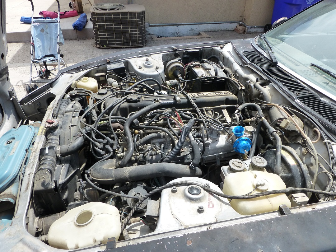

Whoa! You drove it home?! Crazy! I imagine you took the back roads?
The broken left tension rod is why it pulls to the left. I think the brake booster vacuum line or check valve isn't tight, causing the stiff brakes.
I told him that he shouldn't have put the BOV on the ERV/POV port on the intake... that needs to be capped.
But it does pull hard. A good tune up / clean up and the motor will be ready to drop right in.

Yeah, I took the backroads all the way back, took about 1.5 hours to get it back. Never really went over 35 or 40, but I did floor it once or twice to check the boost. I was surprised how much kick it had at higher RPMs over the N/A.
I was trying to figure out why he has the blow off valve pointing out of the hood! It looks ridiculous. I've already started cleaning out the engine bay. If I can find a hoist and stand, I'll be pulling it in a couple of weeks. (after testing compression, etc.) That's when the real fun begins!
