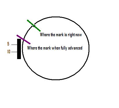

Well, I've been taking a break with the restoration project, and now I'm getting back into it again.
Here's a problem that I still haven't been able to fix, and honestly I'm clueless about it.
I want to say I have a timing problem with my car, which it may be the reason why I have all that popping; however, I don't really know at this point. So, I read my Haynes book and I'm supposed to be at 8 degrees +-2, if my memory serves me well. I bought a timing gun, and well...the timing mark is completely off...not even close to the timing plate by at least 1.5 to 2 inches.
When I advanced the distributor to its max, the timing mark moves just close enough to the timing plate, the plate...not the timing mark. I attached a picture to give you a better idea of what I'm talking about.
Car still runs even like that, but how do I go about fixing this thing? Oh, if I advance the timing, the popping is not as noticeable, but still some.

Did you try turning the distributor the other way? Also this could be a sign of ignition module. When I replaced mine and went back to reset the timing, the mark was in a completely different location. Also you may want to check your plugs, wires, cap, rotor, etc. Also was the oil pump at any point removed or reinstalled?

If I turn the distro the other way (clockwise), it retards the engine.
All wires, rotor, cap and plugs are brand new.
Yes, this has been a lingering problem since I rebuilt the engine. Yes, the oil pump was removed along with everything else.

Sounds like the diffy is off by a tooth or two on the oil pump drive gear. You need to drop the oil pump and index the dizzy drive shaft by one tooth in the proper direction.

You need to set the motor to TDC, drop anti-sway bar, drop the oil pump, align the oil pump dots, and re-install. There is a section in the Haynes manual about installing the oil pump correctly. I believe the rotor of the distrib should be pointing straight forward to the radiator for cyl# 1
