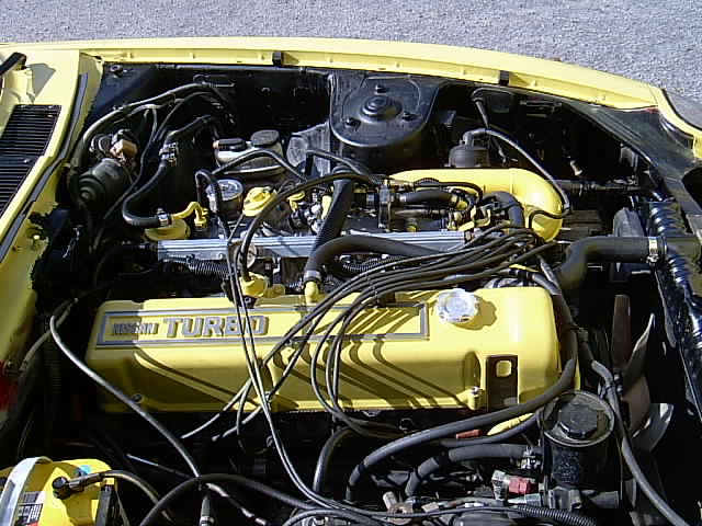

Having just put in a new motor in my 83 turbo, I had similar problems although not much to fix. I replaced the brass washers as they were in my gasket kit. No oil leaks. The other problem was the car running a little rough at start up.....OK, I checked all the connectors that I was so sure were connected and found two were not seated very well. Engine runs smooth.
I changed all the vacuum lines on the intake.
Rebuilt the engine completely.
Some new sensors, cyclinder head temp.
Cleaned the ECU connectors prior to firing.
New hoses and belts.
Check you banjo brass seals and as suggested, make sure there is no dent on the banjo. Its just leaking oil.
