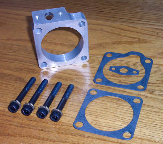

I just have the 240SX TPS mounted right now. The TB is on the ported plenum that's sitting on my mountain of parts. I've been so busy working on the car I haven't had time to make room in the garage. I have the Gray's Garage 240SX TB adapter which it looks like he doesn't make anymore. Too bad - it was the only one with the port for the stock system.
