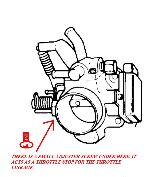

I'm looking through the Haynes and they show there's a screw on the throttle body for adjusting the idle, but I'm looking at that throttle body on both my cars and I can't seem to find the screw that adjusts idle. I was thinking maybe you could only change idle on the N/A like in the Z31, but I don't see the screw on the N/A. All of them look more like mounting screws. If anyone has a good pic of where the idle adjustment screw is that would be helpful.
Look at the passenger side of the throttlebody and you'll see where the throttle linkage rests against the throttle body. There is a small screw that threads up from underneath, through the throttle body and contacts the throttle linkage. This screw determines how far open the throttle plate sits when you have your foot off the gas. Adjusting the screw up will open the throttle more and raise the idle. Bringing the screw down will close the throttle more and lower the idle. There is no external idle adjustment screw like on the NA's. I'll see if I can find a pic.
