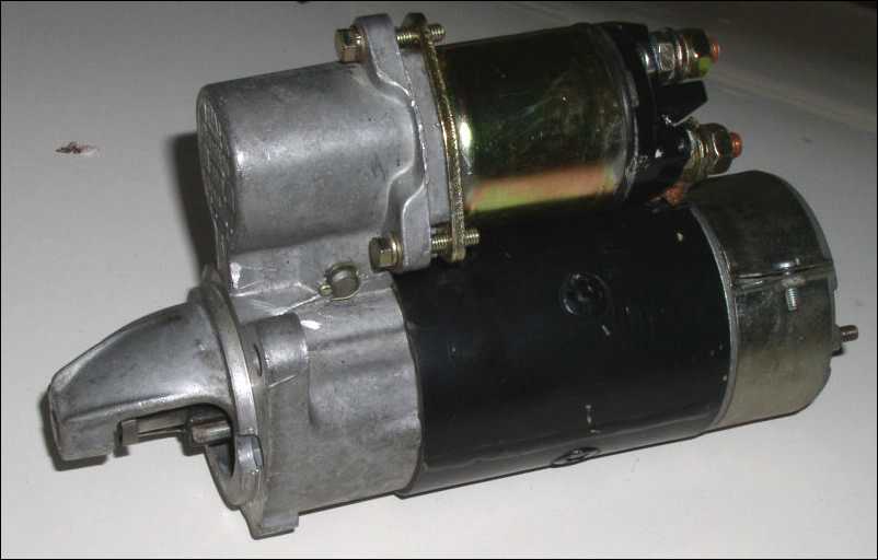

Now this is going to make me sound like a noob, but where is the starter motor. I've never had to mess with it, so I'm not sure as to where it is. Or at least the wire to disable the starter motor?
Starter motor is located at the right rear of the block (attached to the tranny bell housing). Trace the + battery cable & wa-la! This is what it should look like:
