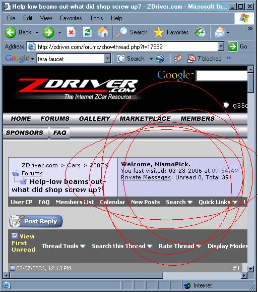

Old Mar 28, 2006 | 10:12 AM
Originally Posted by jjohart
This is an 83 280ZXT...what are pm's?
PM= Private / Personal Message.... You check them by clicking on "Private Messages" up at the top right of your screen.
