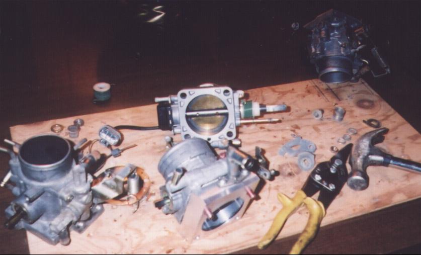

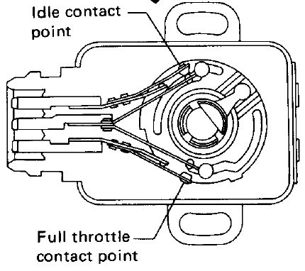

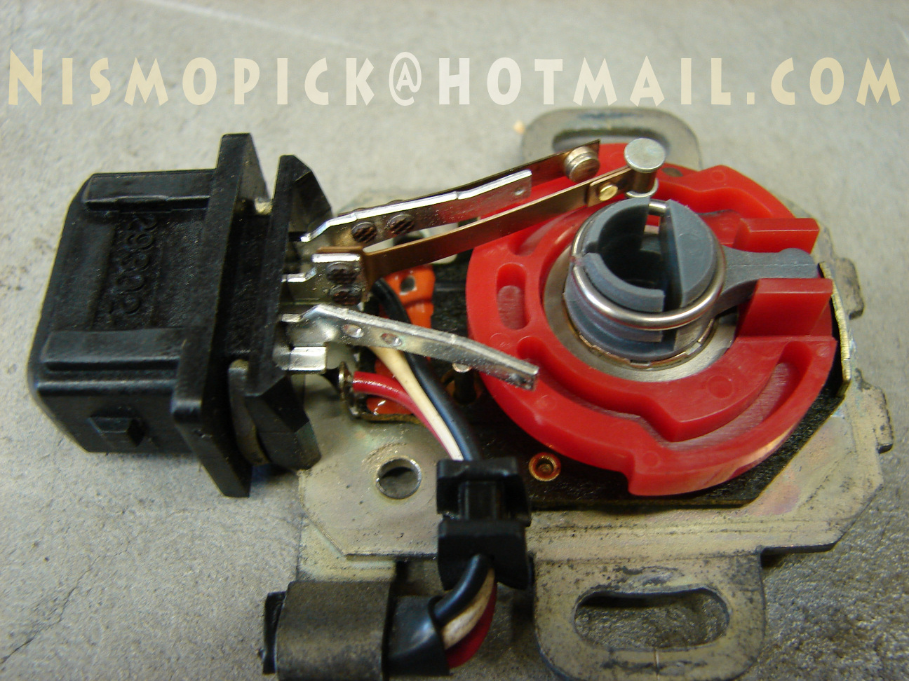

The 240sx 60mm TB uses a different mount for the TPS than the stock 280zx one. But, the 60mm TPS only has the idle switch, nothing else... just on or off.
See pics:

It's the same as the 280zxt one. The 280zx n/a has the idle switch AND the full throttle switch. I imagine people use the 240sx one because it has the pig tail for other connections too. It's not a potentiometer though... that's the main thing.

i got why everyone is using the 240sx one. there are 2 connectors, one that is exactly like ours, on/off same plug. then there is a pigtail coming out, it is the potentiometer and gives full sweep of where the throttle is. apparently the auto trans cars only had the pigtail, and no switch. took me long enough to read about that one.
Old Feb 28, 2011 | 07:45 AM
^^^ Interesting. That third pic I posted of the red 240sx TPS has a pigtail. I took it all apart and never saw any kind of potentiometer sweep. I thought the pigtail wires were connected to the main TPS plug wires... but looking close at that pic, I'd say there is a separate circuit board. I think I need to cut open another and check.

the red part is sitting on the sweeper i bet. looks like its attached to the board material under. now i just gotta find one. i also found out it mounts to my tb. kinda ghetto like, you use washers and the stock mounting. the washer holds it down with the screws, but the screw doesnt go thru the tabs.

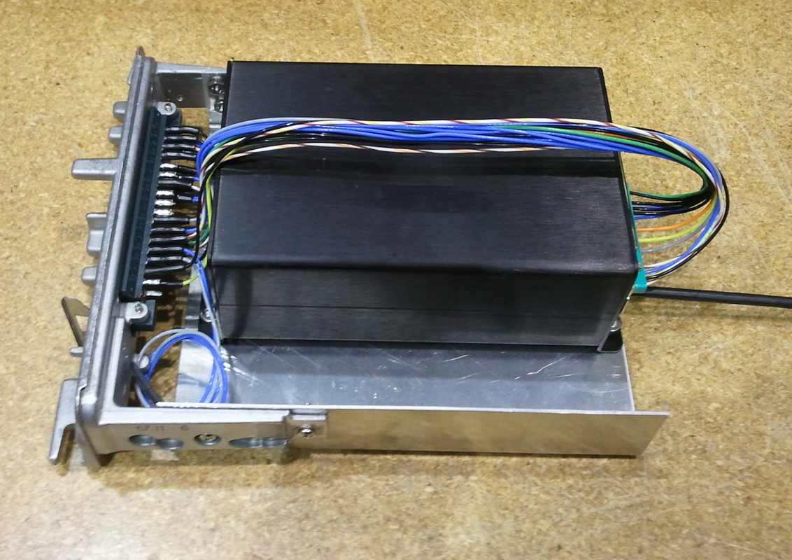

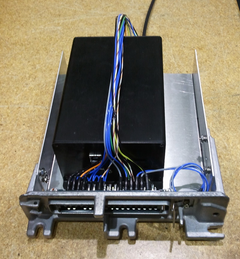

Here's the first prototype - it's rough but it should work to plug into the stock N/A harness...

Rough? It looks awesome! I'm to do this to mine once I get my tax return, I would appreciate a write-up when you're done.
No problem. Are you running NA or Turbo? I'll do a set up for the turbo harness as well. I've got an old 200SX ECU which is the same plug configuration as the 280ZXT.... the one above is from a Maxima which apparently doesn't use the cold air idle valve on pin 23....
