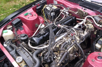

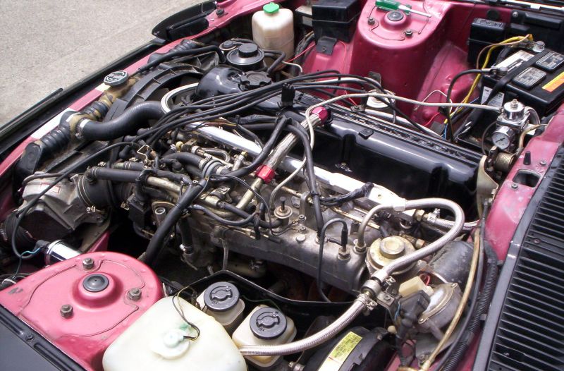

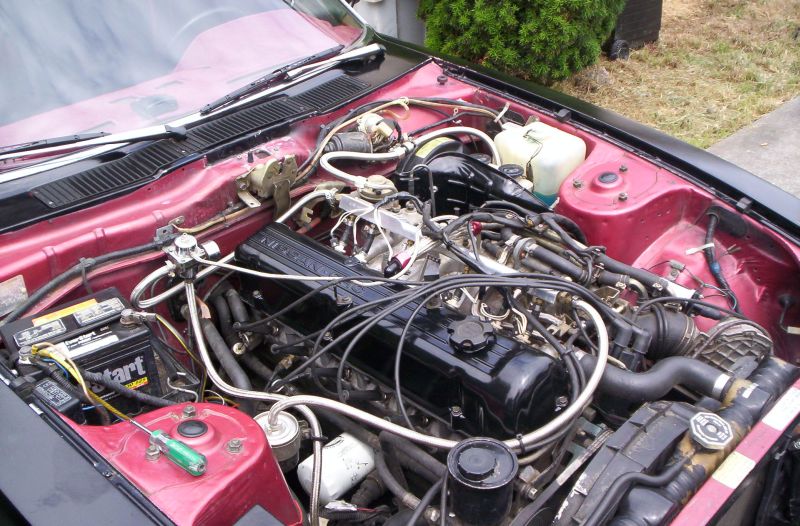

Old Nov 3, 2006 | 02:27 PM
Originally Posted by 007max
Also, what pressure is the stock FPR set to? I did not want to reuse it so i got an adjustible one and would like to know what to set it at...
Here are a couple of pics of someone that has the fuel rail, and adjustable fuel regulator. This is how I am setting up mine on my '82.
Attached Thumbnails Fuel rail question-power-coating-002.jpg   Fuel rail question-power-coating-005.jpg   Fuel rail question-powercoating004.jpg
