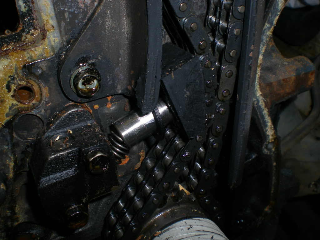

There is a little hole that the tensioner slides into? Behind it? I assume there would need to be one for the spring...
On a scale of 1-10, how retarded is it to reset without taking the timing cover off?
Old Aug 2, 2010 | 04:28 PM
  #53
11 on the scale of retardedness. I think ONE person ONE time claimed on HBZ to have reset it w/ a small long screwdriver.... the actual chances of getting it in blind is very slim to none. In any case, your cover is off right?
I don't think there's a hole for a pin lock like newer motors (I know the KA has one). Just shove it in & keep tension on the chain w/ the block of wood you should have used in the beginning.

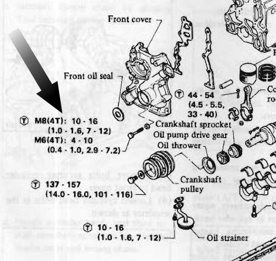

Alright, manned up, took that bitch off, chucked it, now i'm sitting here with a broken water pump bolt and no idea what TQ the timing cover and water pump bolts should be at.
Info plox?
Old Sep 1, 2010 | 08:05 AM
  #55
You're doing all this without a manual?
Here are your torque specs (BTW, you can download the FSM at www.xenons130.com/reference)
Old Sep 1, 2010 | 09:02 AM
  #56
I have a manual, and as soon as I saw this, I turned like, right to the page I needed. I may need some help with my timing in a few days, unless I get my friends L28 out of his wrecked 280zx, as he has rb25 plans for it.
