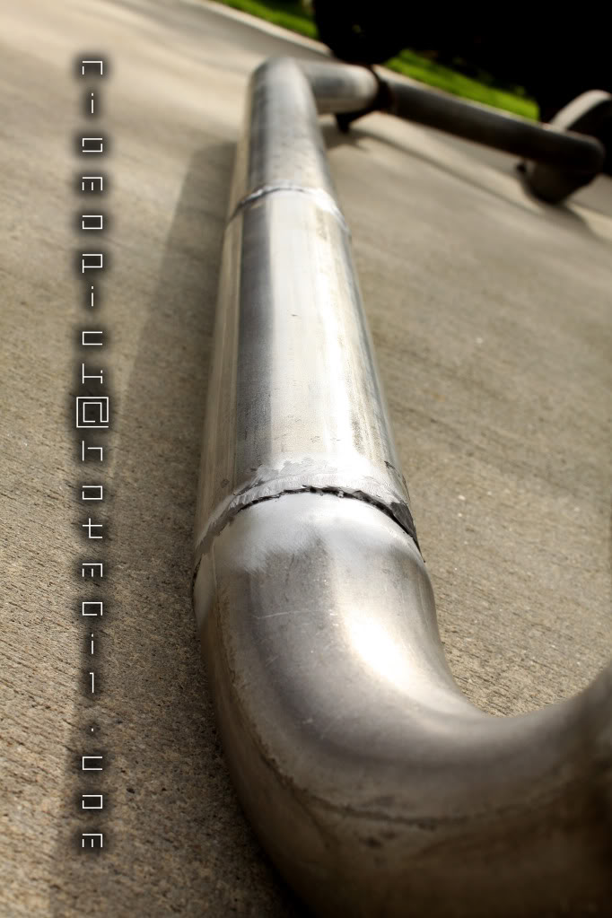

https://www.zdriver.com/forums/240z-260z-280z-motor-swaps-non-v8-269/l28et-s30-tucked-like-stock-only-better-pic-heavy-30516/

Old Sep 27, 2010 | 07:21 AM
Were you admiring how the turbo looks so fresh, and the downpipe so rusty? I should have media blasted the downpipe, but it will eventually look like that again anyway.
Old Sep 27, 2010 | 12:39 PM
WanganDevilZ's Avatar
The Emblem Thief y0!
Posts: 948
From: Tulsa, Ok
I didnt want to quote all your pictures. Most of the engine looks clean.

looks simple enough to fabricate ,just don't have a place i can really do it myself the turbo in those pictures newly installed which my stuff could look that new all times.
