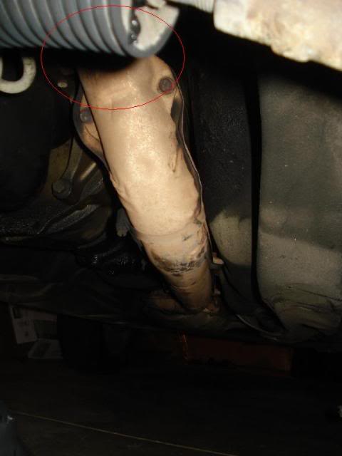

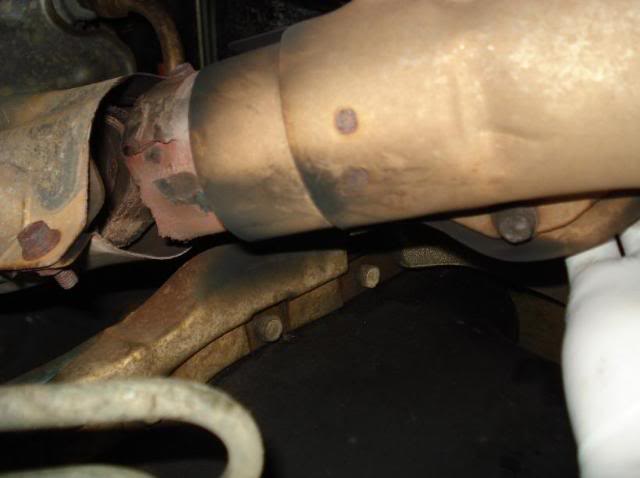

i was driving my 83 280zx n/a today, and suddenly, the exhaust sound got a lot louder. like open pipe loud. annoyingly loud.
so when i got home, i put it up on stands and looked underneath it. muffler's there, cat's there, but following the exhaust pipe up towards the engine, i found a leak. well, more like the pipe's busted. please see pics:

is the only solution a new exhaust system? headers and exhaust? i got a friend who can weld very well, apparently. what should i do??
thanks guys!

well. the cheap way would just replace that section of pipe. If you can get it off with out busting a bolt on the manifold. That section just runs from manifold to cat, and unbolts on both sides. For lots, perfect time for a new header.

I would just weld it myself. They do make a clamp you can put on. tho it was made to cover holes. not hold pipes

I think that's a bit more than just an exhaust leak XD
If you can get the heat shield off I would just take it to an exhaust shop to have it welded, shouldn't cost more than $20

take it to the exhaust shop, have them weld in a piece of pipe where you tried to put that tin foil
or go to the JY, get a replacement piece and do it yourself
