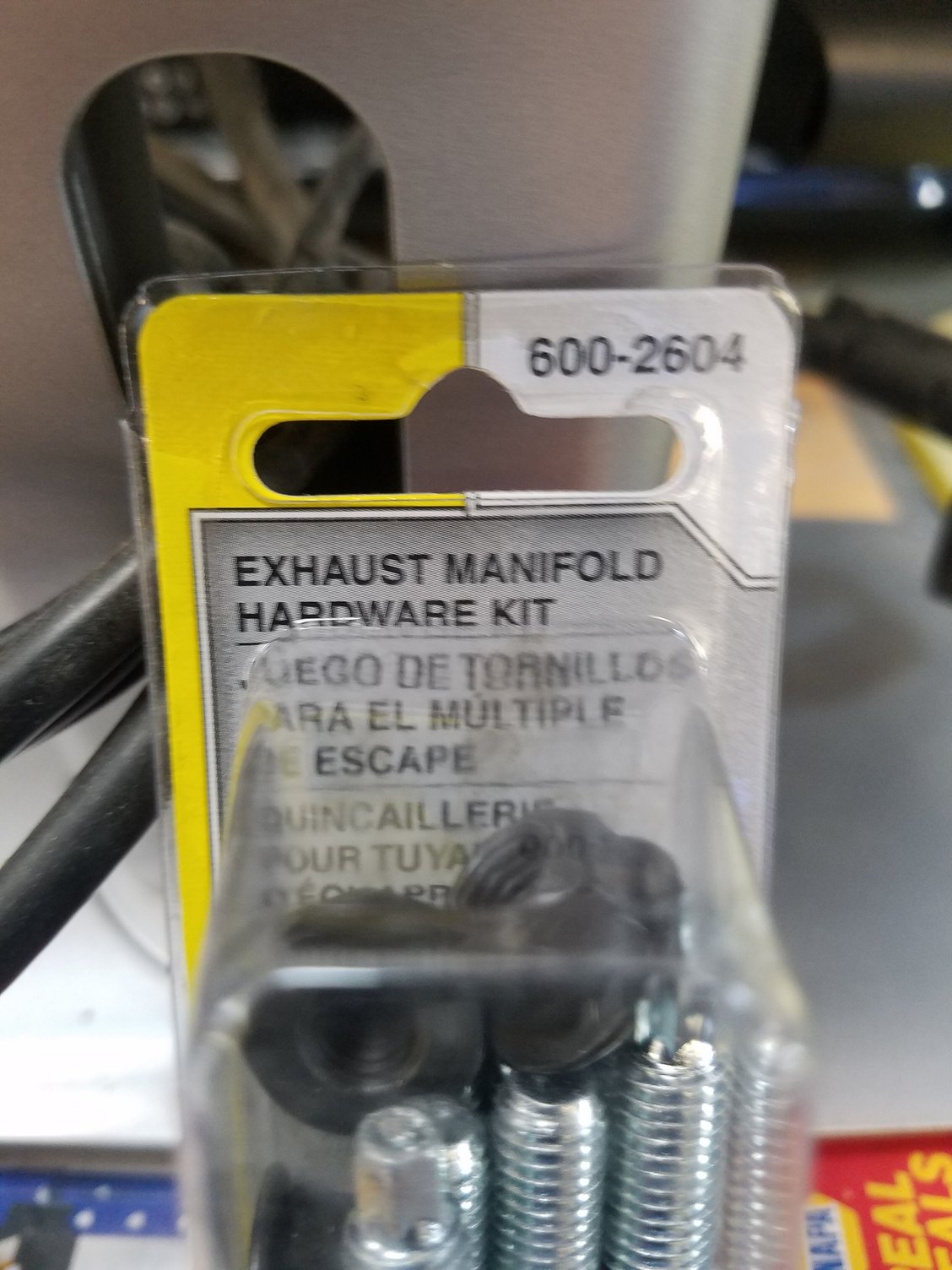

Dont use stainless. It is way too soft! You need hardened exhaust studs to replace the broken bolts. The front and rear bolts breaking is very common on these cars. I am told by a very seasoned Z mech that it is because of the heat shield that is on the exhaust manifold, not the one between the intake and exhaust. He recommends removing that shield from the exhaust manifold. You may be able to find a stud kit at your local Oreillys or Napa. Here is what I used on my 3 Z's . Put these in both the front and back holes. Run a tap first to clean the threads. A little red locktite never hurts. You can get a lifting lug like the one on the front to bolt onto the back bolt.
