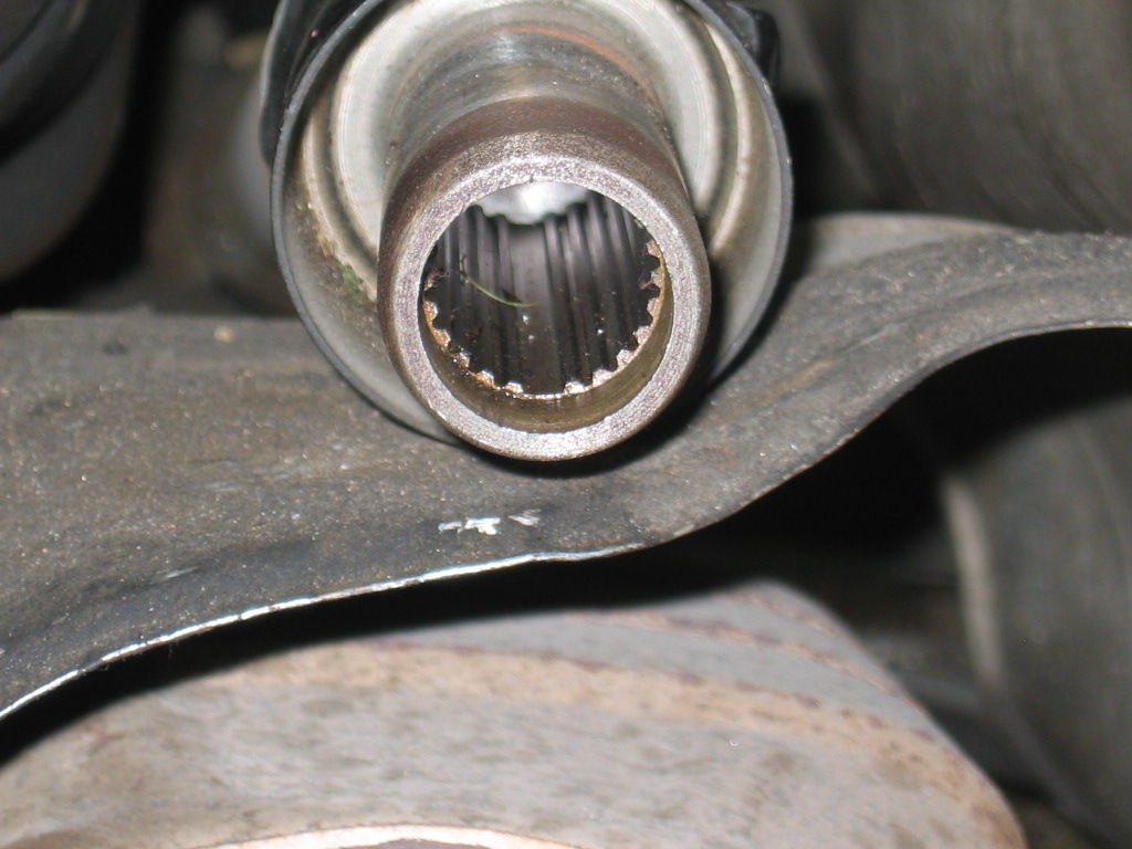

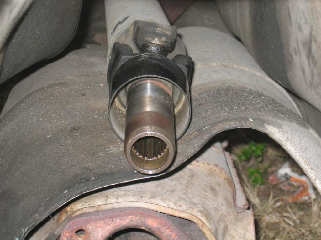

I just want to double check on something...
The two pictures here are from the AT driveshaft and I closely looked at the MT driveshaft and they seem to be identical. They both have a gap at 90 and 270 degrees in the circumference. Both have 11 grooves at each side, so I'm just thinking if I really need to replace the driveshaft when they look almost identical.

Bumping just to get a quick reply on this

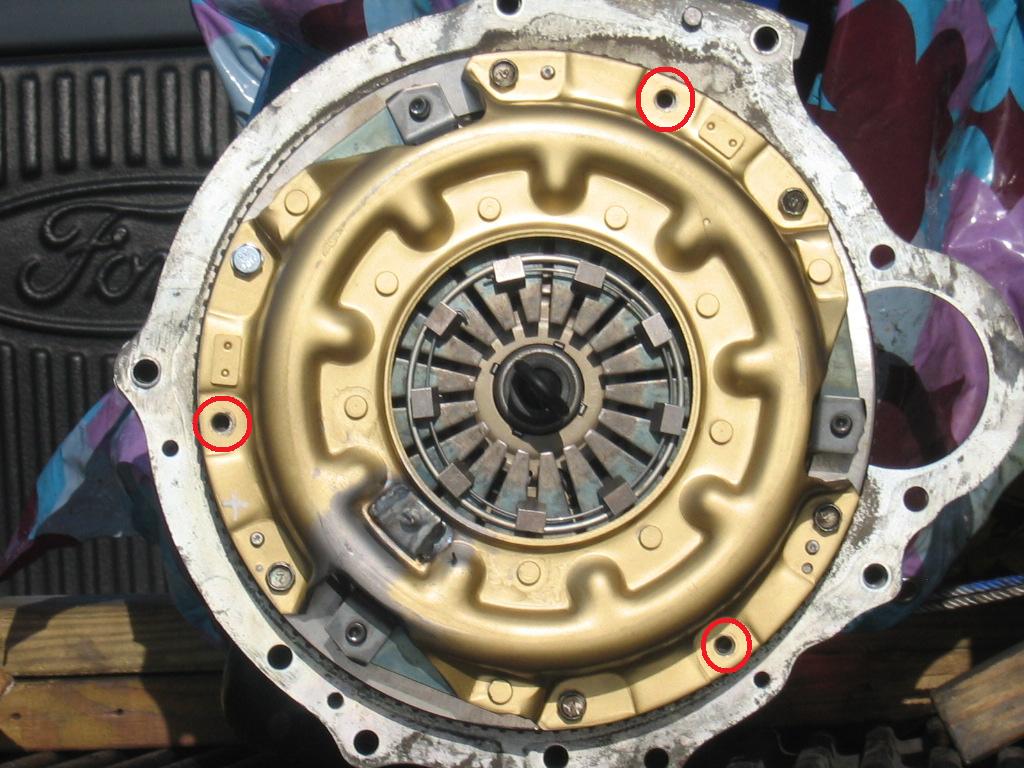

Ok, so the original clutch pressure plate had 6 bolts, but the new clutch pressure plate I bought has an additional 3 holes and I noticed that the flywheel also has matching holes for the pressure plate.
Should I go out of my way and get those 3 additional bolts or should the original 6 do the job just fine?

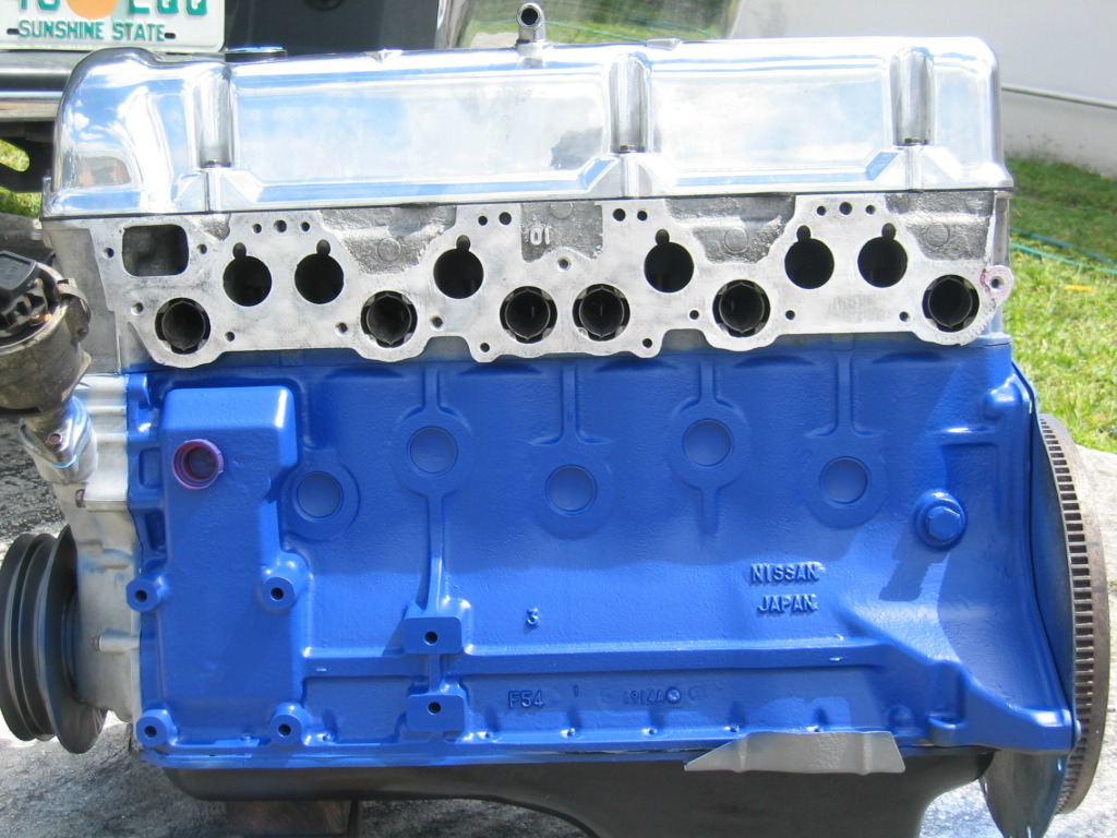

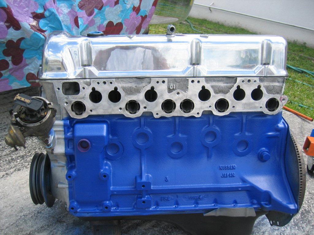

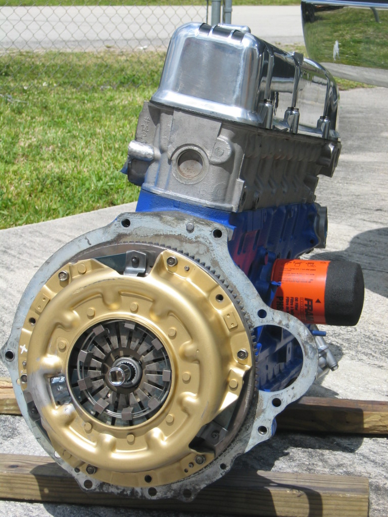

Here's a picture that will explain it better....Oh! and some pictures of my 'new' engine
Attached Thumbnails Engine and transmission mounting..-img_0018.jpg   Engine and transmission mounting..-img_0007.jpg   Engine and transmission mounting..-img_0012.jpg   Engine and transmission mounting..-img_0014.jpg
