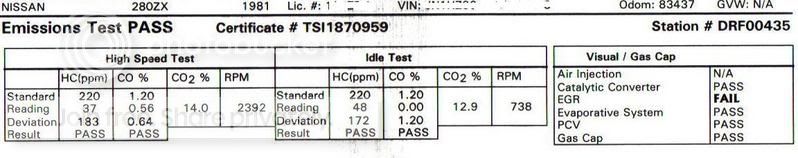

Broke out the Z today & took it to an emissions test center / shop. It was right around closing time so the guy was cool & let me hook up the Z to the emissions machine on monitor mode.
At idle... a beautiful 50ppm HC
High speed test... 100ppm for about 15 seconds, then jumps to 450-500.
Limit is 220ppm. During the high speed, there is an obvious miss... gives a nice "putt" about every 2-3 seconds. So I have 3 weeks to find the prob! All I can think of is vacuum leaks, maybe a not so perfectly spraying injector, er somethin...

Turns out Shady IS still right a lot. I spent a couple hours going through my engine bay... checked all vac hoses (got rid of some I no longer need due to the Z31T ecu ... they were just temp plugged), di-electric greased all efi connections, and still no change. Then I remembered my wonderful advice to SNOWY this week about checking timing... got out the timing gun ... uh... timing set to 30 degrees. WOOPS! Turned it down to the stock 20... better... down to 10... excelent. Gotta take it back Monday & see if she'll pass!

Welp... She passed! Woot Woot! Timing set @ 10 degrees & puts out like a new car!!!

WOW! That's even better than my turbo Z! great jorb
but... I passed at +23 BTDC

Nice numbers man. My Z had about the same numbers when I got mine done. It actually ran cleaner on the Z31 setup than it did on the stock efi haha. I had timing set at 18* and had a slight miss, but the guy said it didn't matter as long as it burned clean.
