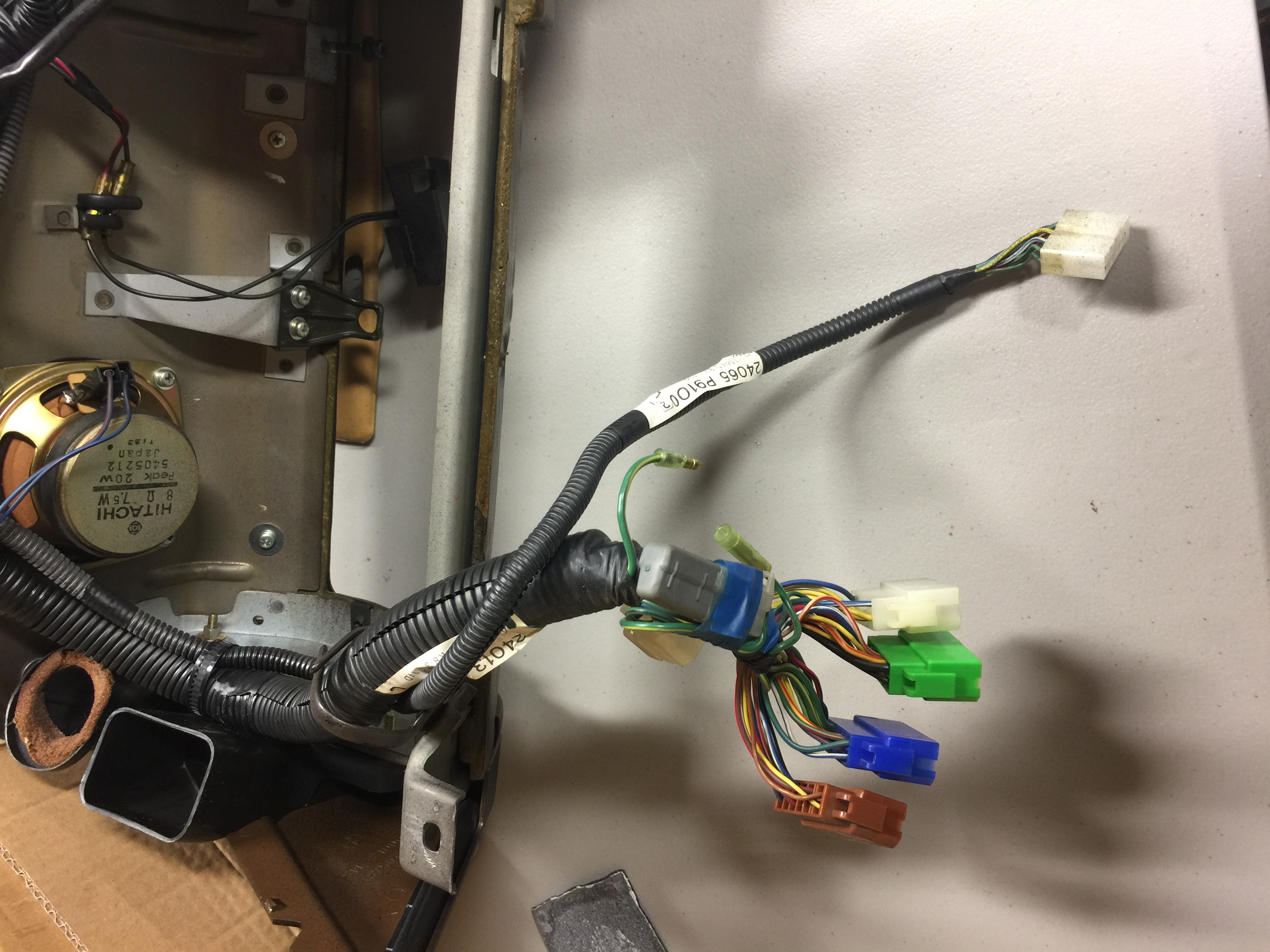

Ok, I just bought an 82 280zx and I started by gutting the interior (Skanky). I pulled the dash and when I went to put it back I have a 10 pin connector that I can't find its mate. Dash Removal/Instal-img_0075.jpg it's a solo white plug that's next to the 4 main plugs on the passenger side. I followed it back on the dash and its for the little "system check box" in the center of the console. Does any one know where to plug this..... a pick would be great, thanks

It goes to the metal box (warning display box) on the dash cross bar.
Please download the FSM right now if you haven't done so... XenonZcar.com S130 Factory Service manuals

Nismo your the Man, That was driving me nuts. Thanks a Million
