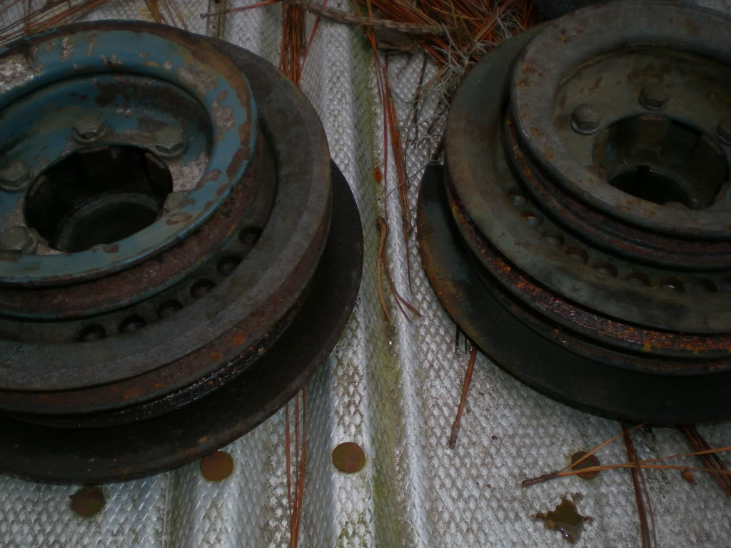

I bought a 79 pulley thinking it would be the same as the 81...
Nope. 79 has 13 counter balance holes, the 81 has 6
Is this going to shake my crank to pieces?

I thought the balance holes were to balance the pulley... no? The internal rotating mass should be balanced separately.
I'm pretty sure they are cast steel.
So why the difference?
I was thinking what you were but we both may be wrong.
EDIT: I was informed that those were in fact balancing holes (like the opposite of wheel weights) and every pulley is different so it has different balancing holes. Awesome!

Frickin told ya!
Who "informed" you?

Frickin told ya!
Who "informed" you?
roger.svoboda on HBZ lol
