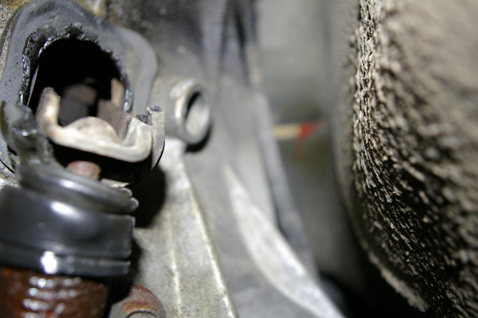

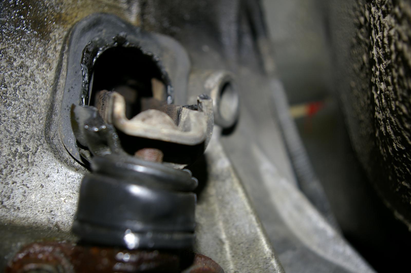

Pictures of "rubber part"
Here are a few pictures I took of -- what is left of -- the "rubber part":
Attached Thumbnails Clutch problems-_igp3073-2-.jpg   Clutch problems-_igp3074-2-.jpg   Clutch problems-loretta.jpg
Old Jul 20, 2011 | 08:48 AM
You are asking about the fork seal? That doesn't do anything but keep dust / dirt out of the transmission. It's the seal on the slave that is leaking:
