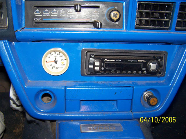

I remeber how much of a pain in the *** it was for me to custom make me a metal peice to fit perfect in my dash so i went down and bought some thick sheet metal and i used my dremel i moved the c.d. player from the center of the consol to the far right side and the remaning space to the left i put in and after market boost gauge mine looks real clean and nice i think i did post pictures of it... all i have is a high power pionner 45x4 out put going to 2 6.5 kenwood 2 ways in the back seats and 2 kenwood 3way 6x9's siting in sealed boxes in the back i just picked up a slim wedge 8" duel sub box for free ill be hooking up a 200 watt amp to 2 kenwood 8"s
Attached Thumbnails Audio for the ZX's  ENTER HERE-000_1150-copy.jpg   Audio for the ZX's  ENTER HERE-000_1152-copy.jpg
