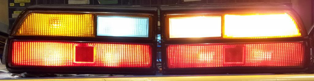

Well this is one of those you need to see it in real life but here's a picture to kinda give you an idea. Basically the red seems to be brighter with the LEDs and the orange signal is bright but not as bright as the incandescent bulb. The backups are pretty similar but however the camera interprets the light it looks a lot brighter in the picture and it makes the backup look quite yellow and brighter than it is in comparison to the LED. I didn't take any pictures of the side markers but the results are similar. The red LEDs are slightly brighter and the orange is slightly dimmer.
Left side - LED
Right side - Incandescent
Here's the BIG difference. The power consumption. All the lights on on one assembly with incandescent is 7 Amps - the LEDs are less than 0.5 Amps! That's just one side of your rear tail lights. There's some serious load taken off your electrical system with the LEDs.

the look of led's in our taillights isnt being done justice in the photo. at night the colors are extremely vivid. ive done this to mine by piecing it together but this kit offers a quick easy method. dont forget that the less power the laternator puts out the more power the engine gets to the wheels!!

As Shady is saying it is different at night (and in the day with your own eyeballs compared to the camera) because the light is a specific wavelength - eg red through a red lense instead of white through a red lens - all the other wavelengths except red are stopped by the lense with a white light.
