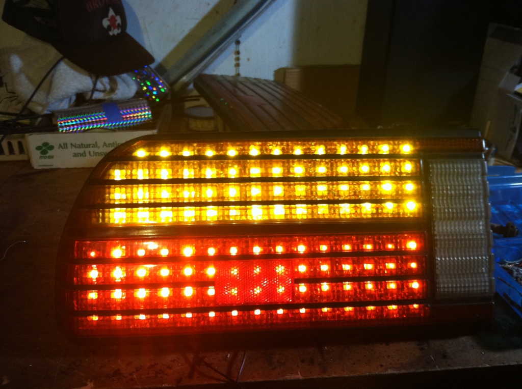

Are u talking about something like this?? If so i would be interested too!
Attached Thumbnails Anyone interested in an LED conversion kit?-f93f1ba2.jpg

^^^ Yes! That is dope, but would probably be quite a task to make a full circuit board for each light.
If I had all the equipment, I would make a set of clear tail lights and use LED light tubes... kinda like the BMW E39's (One of the main reasons I bought this E39).
That's totally doable - problem is you need to destroy your taillights to get the PCB inside.
Definitely the kind of thing I was talking about. Has anyone tried the oven trick for separating the housing to insert them?
