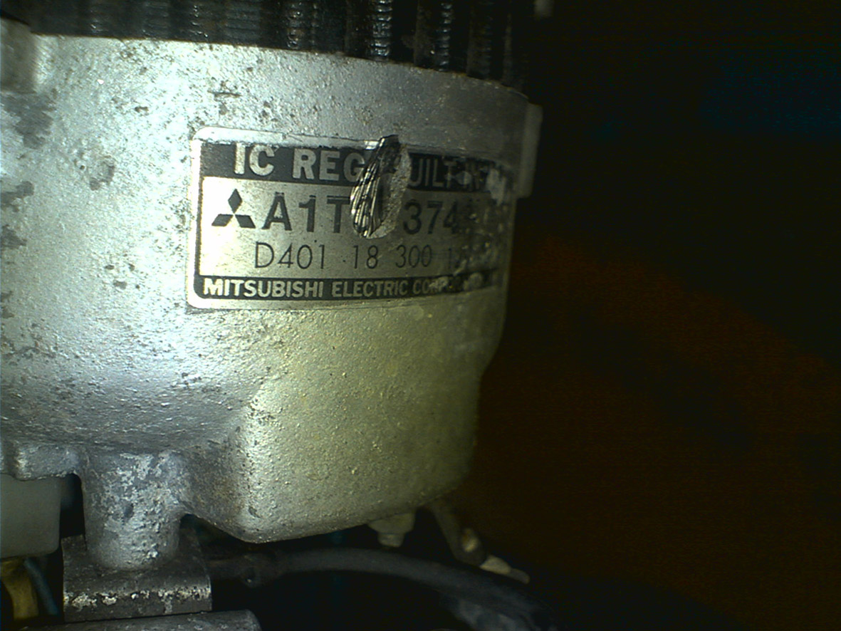

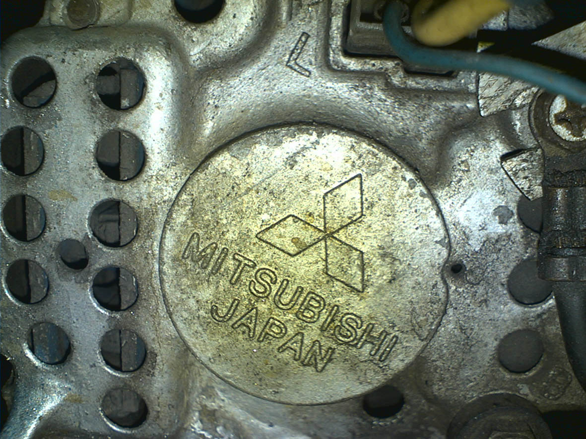

haha no wonder mines a piece of ****. it's a mitsubishi alternator that pumps out 40a.
in saying that, the model number is a1t31374 so if it bolts stright up maybe there is one with higher output that will too

mitsubishi makes all sorts of stuff and there is often a standard for a little while unless its a honda car. odds are its a similar year but from some little car like some sort of econobox.
40 amps is nothin, must have had a hand crank in the front what ever it was meant for. i am sure a regular alternator or something with a little more umpf and it should run a bit better. i think 40amps is mabe barely enough for normal operation. the only reason i am looking at these 90 amp alts is because the guts are newer technology and i may be putting a stereo in it but i dont know how far i am going to go with it
