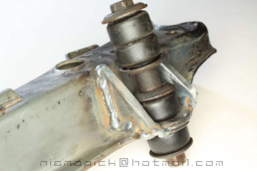

Don't use urethane bushings on your TC rods. I know some guys get away with using them on one side - just don't remember which - probably the rear one. Lots of horror stories about TC rods breaking from urethane bushings - not worth the risk to loose your steering while you're driving...

Don't use urethane on the tension rods, my tension rods have snapped twice on me because of them, first time i was just cruising down the highway going 60 and all of a sudden it felt like a rock came up and banged my floor board, but it was the rod snapping, second time i was going over the metal plates they put on the ground during road construction and it snapped again.
It broke in the same place too, right where the bushing rides when the rod takes a step down and gets narrower.

I'm an engineer and have some knowledge of material science. Here's a bit of knowledge. All materials have a yield strength which is basically the definition of the point at which a material will deform (yield). Materials also have a tensile strength which is basically the definition of the point at which a material will fail.
If you stress a material to its yield strength and release, the material will return to its original shape, if you stress a material to its tensile strength, it will break.
The rubber bushings obviously have a lower yield strength than the polyurethane bushings.
Now, when we are driving down the road, there are all sorts of forces interacting with different components throughout the car causing fatigue. There's nothing in the world we can do to remove those forces and the resultant fatigue except rebuild the roadways without potholes, cracks, bumps, etc (which is fine on the racetrack). The only thing we can do is dissipate that energy. Well, all cars have shocks on them, however, shocks only work axially (the two ends of each strut/shock never move from that axis). As far as cyclic loads are concerned, shocks can only dissipate the portion of those loads that are parallel to the shocks themselves. The other portion of those loads must be dissipated by other means. That's why we use rubber bushings. We use them because we want them to take the majority of those loads (not parallel to the shocks/struts) away from all other components on the vehicle. In other words, we want them to wear out before anything else does.
mrprofile is probably right about half and half not having any benefits. It means the poly side won't yield, and the rubber side will receive twice as much cyclic loading which means it will wear out twice as fast.
BUT, some people use poly and to protect their tension rods they do some welds to increase strength like what Nismo did, or they buy some other aftermarket tension rods that are stronger. However, those loads are still there and are still transmitted to something else, to what, we may never know until someone has used poly and stronger tension rods and has been driving their car for another 30 years after such work and can give us his experience. It may mean the tensile strength is NEVER exceeded on any component and you just have to deal with a bumpy ride for the life of the car, or it could mean some loosening of nuts, bolts, screws, etc over time. Personally, I'd prefer to just stick with the original design and assume the guys at Nissan knew what they were doing. In my case, it is a street car after all.
jmw_man
