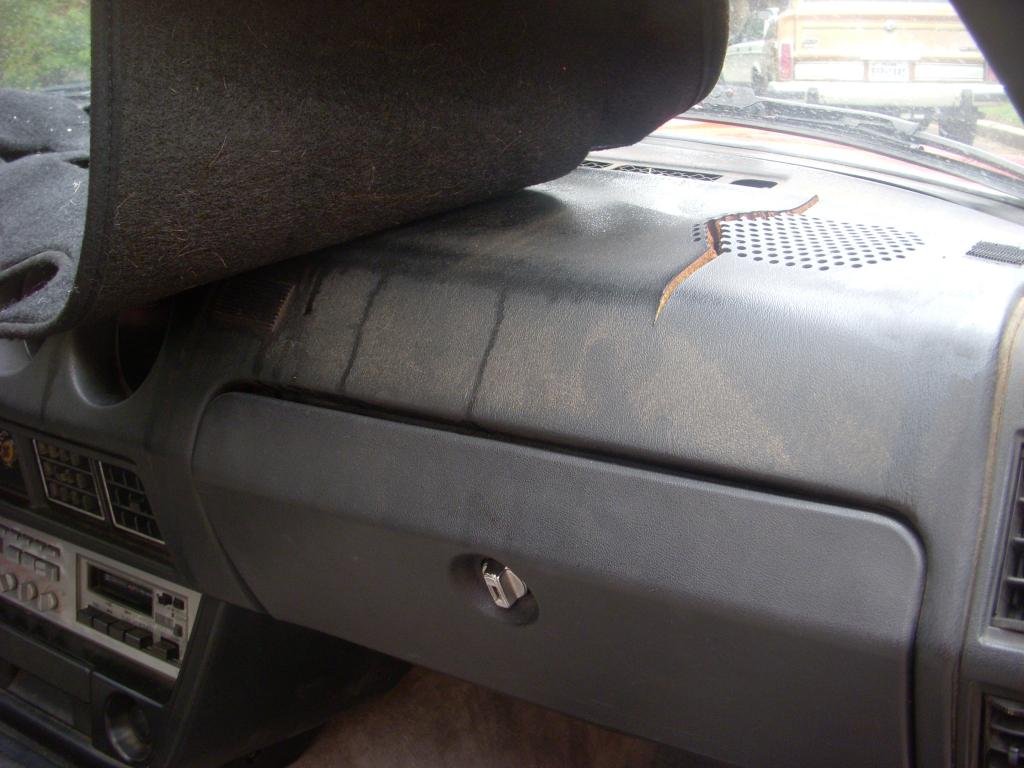

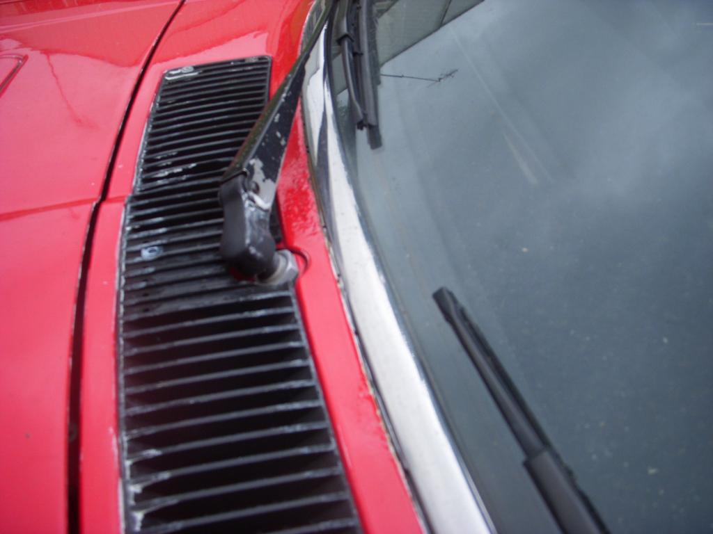

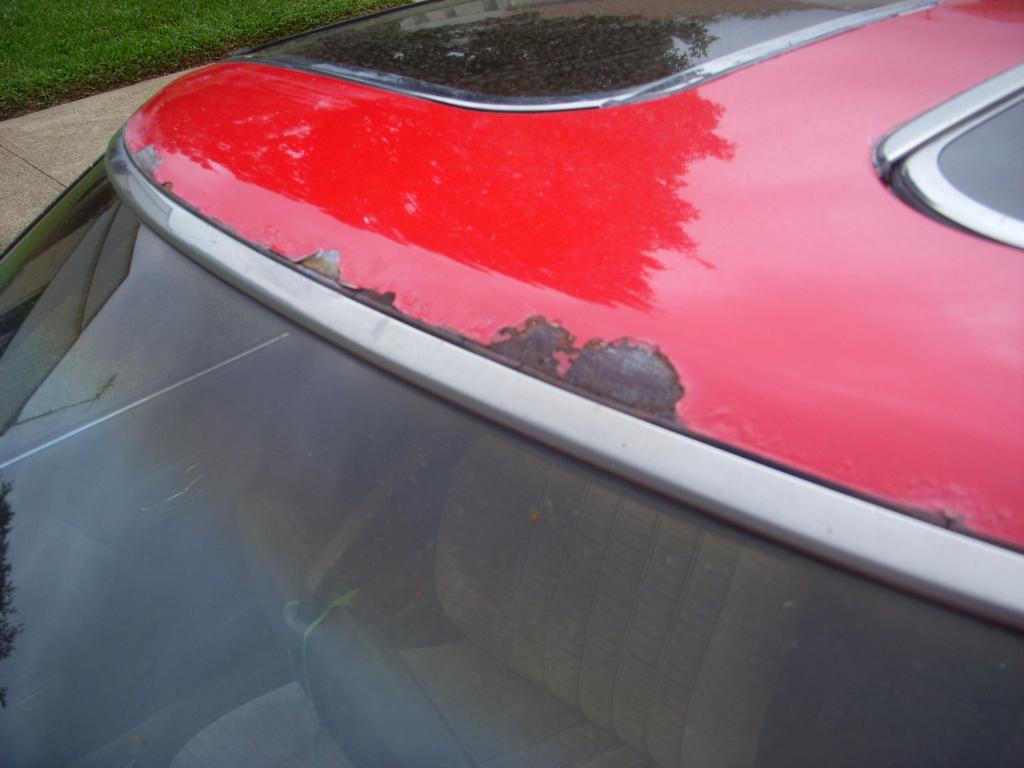

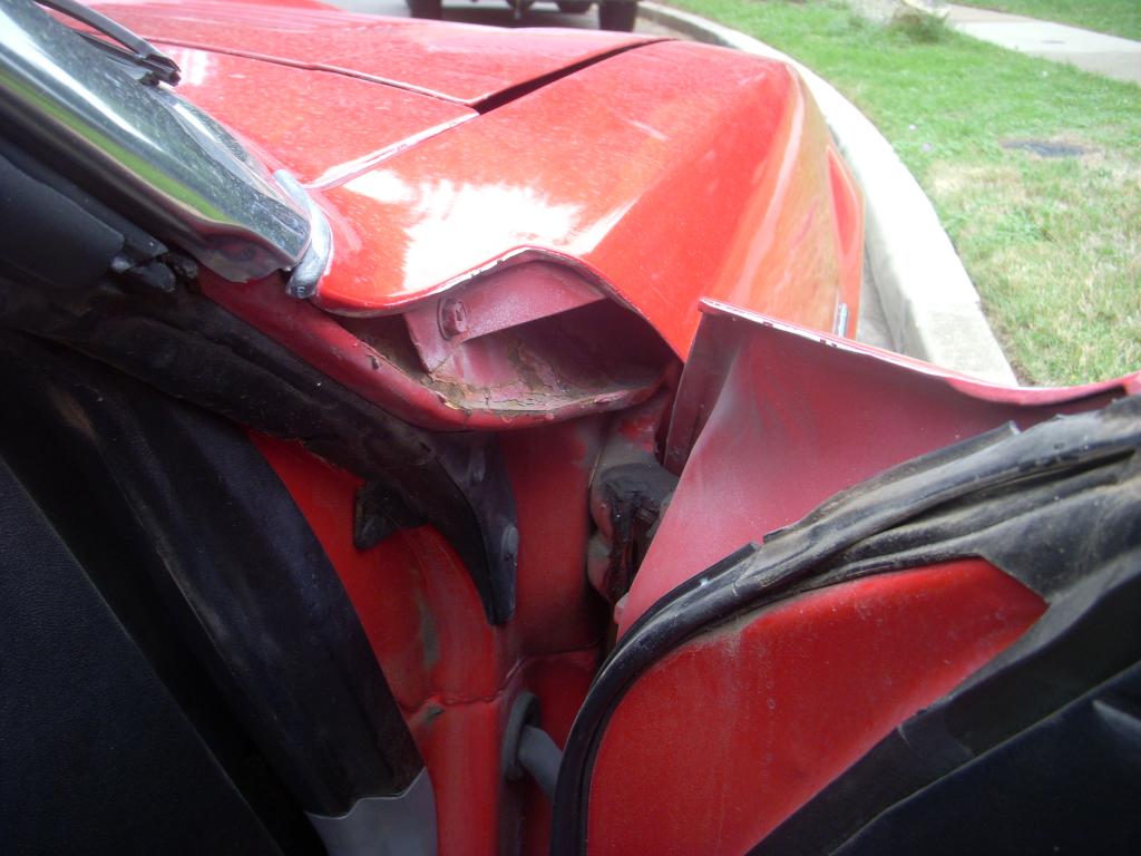

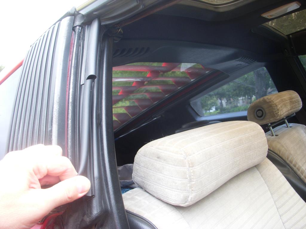

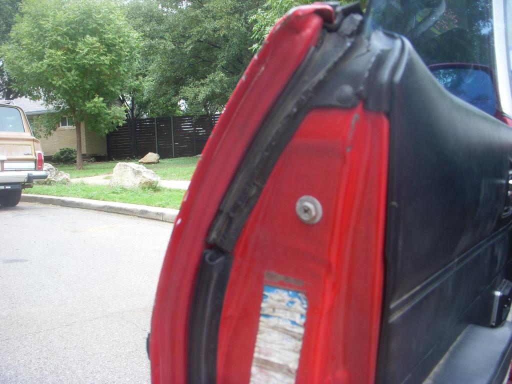

I've been going back and forth on my Z car on what should be down before something else. The car needs rust removal and paint. The car also needs rubber seals and such replaced. The interior also needs work, dash is cracked up and I have one of those carpet covers that I don't really like. The drive seat is torn and the foam inside it seems torn.
I noticed the radio doing funny things like randomly turning off, or not turning on unless I hold the button down, the scan buttom randomly working when I didn't press it, etc. In another thread I mentioned problems I had with my antenna switch not working and after pulling the radio out and simply looking at it and then putting everything back together the antenna started working again. The weird thing is before when the antenna didn't work the radio worked flawlessly and now it's back and forth. Long story short, I think this may be due to water seepage into that area.

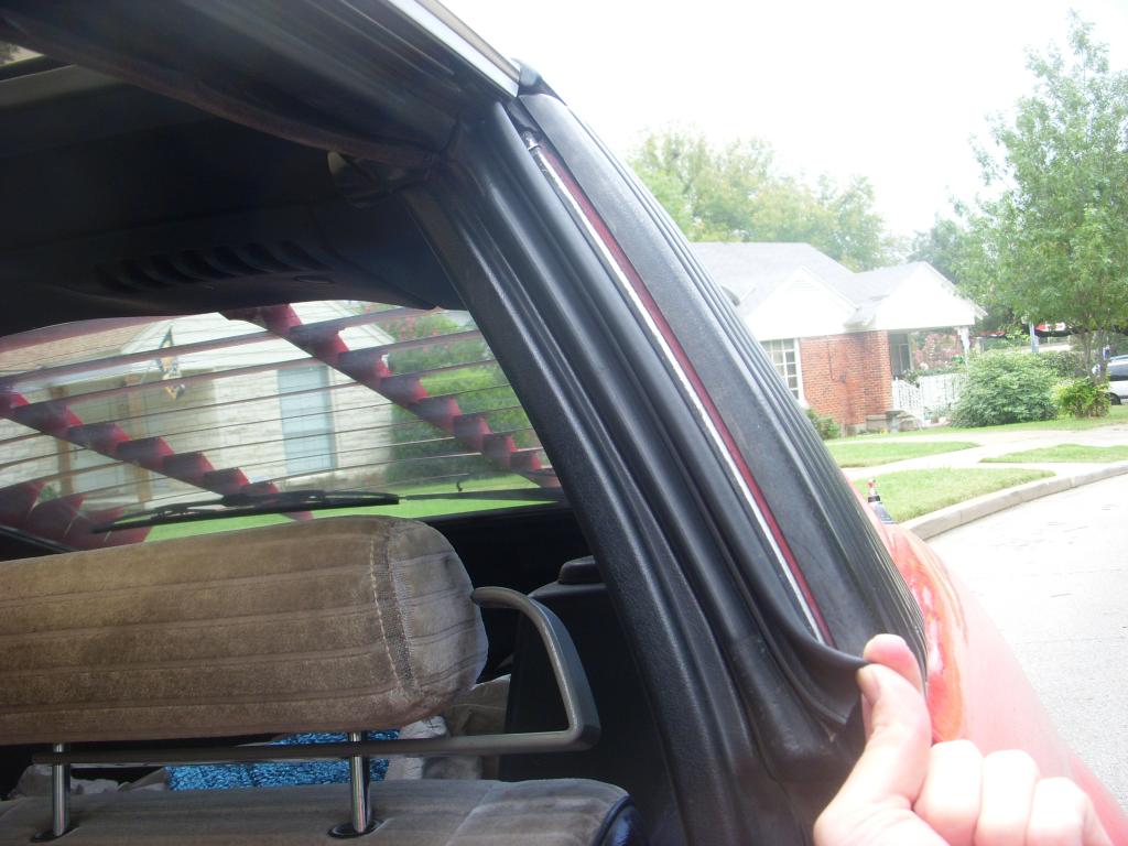

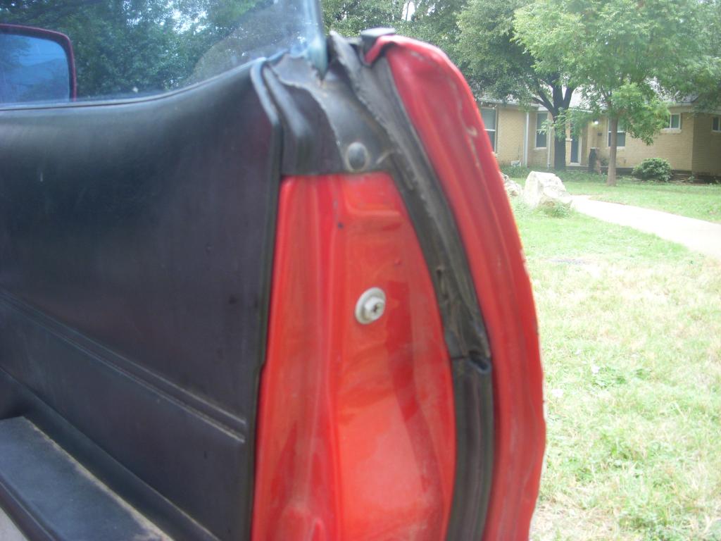

I was telling my wife that I think we should send it to a shop to paint and replace all the seals. She said she thinks we should take care of the interior first and then send to to the shop right after. My concern is making the inside nice before fixing the water leaking problem throughout the car. Her concern is making the outside nice and then scratching it up when we go to replace the seats for example.
Well, I'm supposed to make a list of things that needs to be done. The question is, what to put on that list. There are some obvious things like the weatherstripping, but I was talking to a neighbor of mine and I had mentioned how my dash was cracked up and he was like "oh, that's okay because it's original, people prefer original parts, blah blah blah." My question to you guys, and those of you who are more into restoring a car to original state and not decking it out with updated performance parts or aftermarket accessories, is it important to keep original parts? In otherwords, my seat is torn a little bit, will I be reducing its value if I replace the seats? My dash is cracked up, if I replace it will I be reducing its value? The carpet has tears in some places, will replacing it reduce the value? How about stains, if I can't get stains out, will replacing stuff reduce the value?
