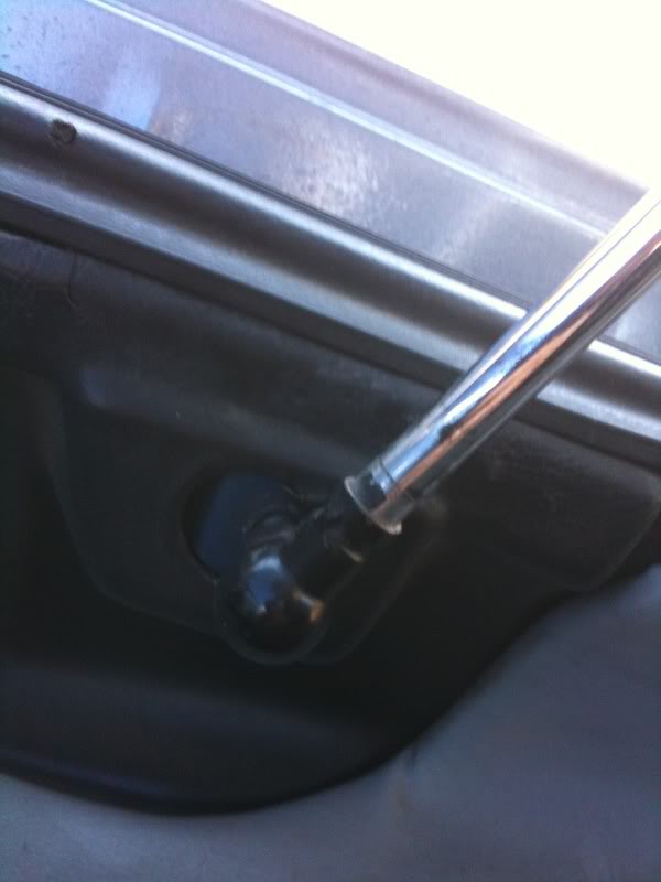

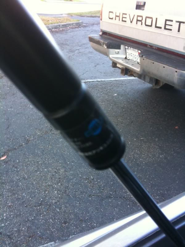

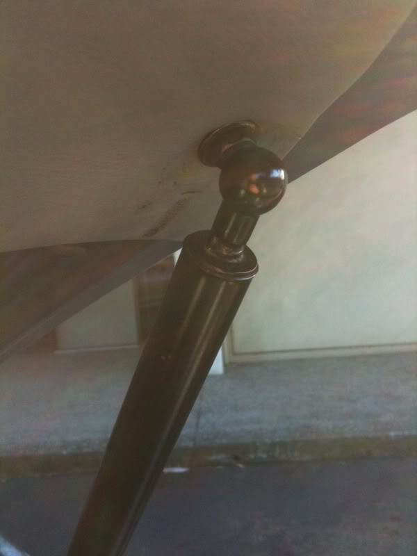

okay, since I'm Probably the only guy that's done this ill tell you how i did it.. first i got the struts from a 90 Z32 2+2 and installed them upside down because thats the only way they would bolt on... i took some pictures this morning and also took a measurement on the cylinder length at 16 1/4" i tried to look for a part number but the only writing on the sticker was all in japanese..

^ Thanks man, that is what I needed. I will try and get a pair of those maybe today. Appreciate the pics, and information. And hopefully it will benefit others, that are trying this upgrade. Rock on man!

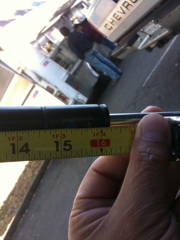

i just took another quick measurement of the strut fully extended and it came out to be 30" from tip to tip.. i looked up the parts you posted and 2 of them showed the physical measurements of the struts one was too long and the STRONGARM Part # 4829 was the closest one to mine.. im just not sure of how its attached... the picture looks different then what i have.. maybe they're using a generic pic
heres a pic of the connecting ends on mine

Hmm...maybe these might work. They are 30.12" in length extended. What do you think? What is .12 of an inch? lol Anyway, thanks for checking that out for me. And let me know if these will work.

should work but you might need to get the lil ball connector thing from a Z32... im not sure the struts you order will come with them...
