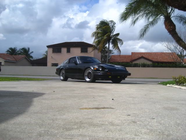

man looks like I got alot of work to do...Well ill try to save up for the MSnS even though i doubt i have the skills to put it together and to get it to run. Anyway im gonna go ahead and buy the parts i listed so far since its a good deal and wait till i have all the other necessary parts for the install. Thanks for the info guys! Ill keep you guys updated, and be asking more questions (after i searched i know the drill lol) Thanks again. oh and heres a pic of my carLMK what you think
