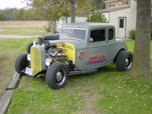

I would never drive a car without headlight washers.....does yours look like this? 1952 Oldsmobile 98 Holiday Coupe at Fast Lane Classic Cars
Nope...Mine is this....
Now if you want to get serious about it, I'll get out my grocery getter.
And if the grocery getter doesn't, get it, then I'm going to up to the joint and have a drink!!!!
Old Codger
The grocery getter is a 406 Chevy. It's a drag car with head lights...No it doesn't have headlight washers!!!!!
Old Codger
When I lived in Phoenix, we really did race them around the building.
