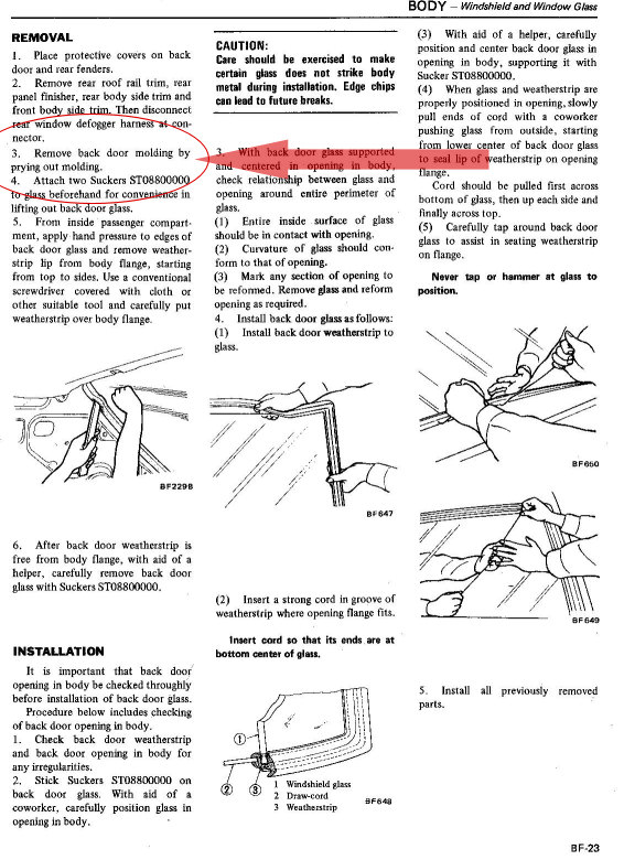

In need of the Z-car experts! How do you get the glass out of the rear hatch without destroying the chrome strips?

hardly a joke. Broke rear hatch glass. I was able to obtain a new glass, but I don't want to damage the chrome strips and seals getting the old one out. Can't replace those! So....anyone ever do this? Suggestions?

They slide out.
Everybody stay with me here...
They... Slide... Out...
From my hard copy FSM ( you can download it for free at XenonS130 - S130 Reference ):
