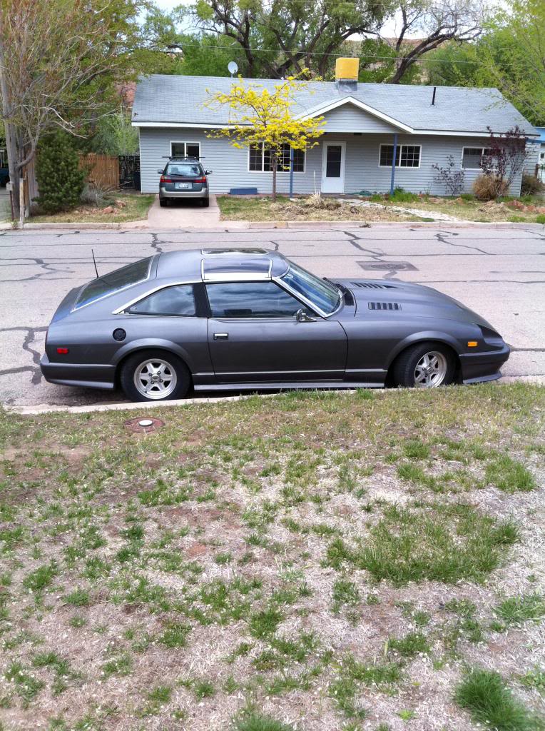

More weight = less performance, the back seat isn't usable, visual proportioning, many interior restoration parts not available.
I heard it described once as all of the ugly and none of the upside.
As a parts car, very desirable. When I parted mine out, I got the 240MM clutch assembly, 3.90 rear end, CV axles.... Some of the late model 2+2's were outfitted as a turbo, except for the engine, to try and claw some of the performance and reliability back that was lost with the added weight.
2+2's are still a Z, and I had a lot of fun with mine. I wanted a full interior restoration and finally realized that I was going to sink a ridiculous amount of time and money into that last 10%, or else just live with an unfinished car.
