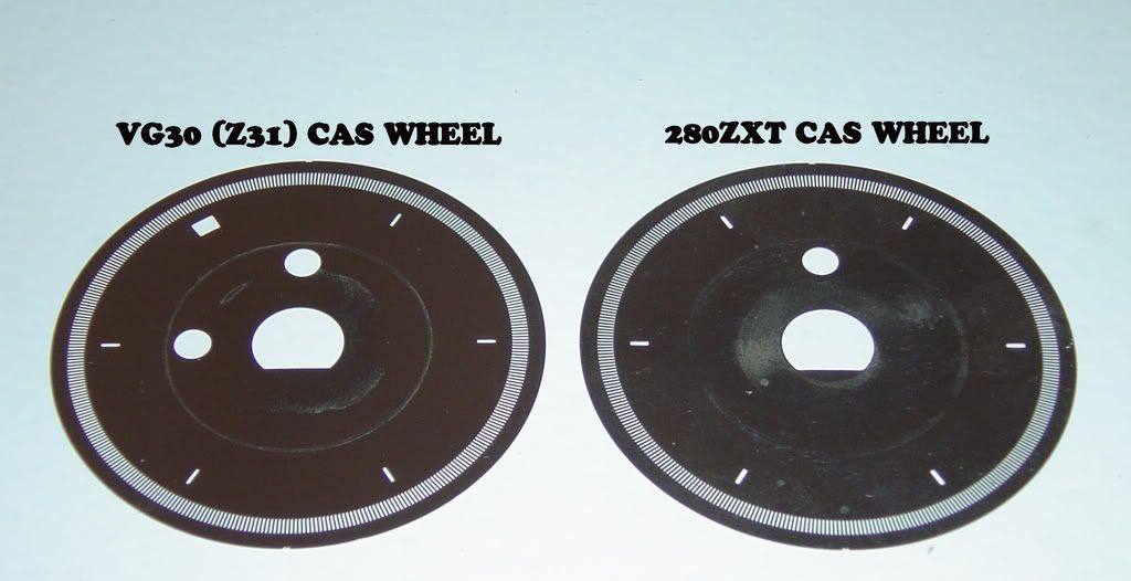

Originally Posted by duowing
You said that the Z31 chopper wheel was different from the 280ZX chopper wheel right? This is weird, and I'm wondering if the chopper wheel that's already in my current dizzy is a Z31 wheel...
Sorry to dredge up an old post, but I got another Z31 chopper wheel & decided to compare it to a 280zxt wheel:
