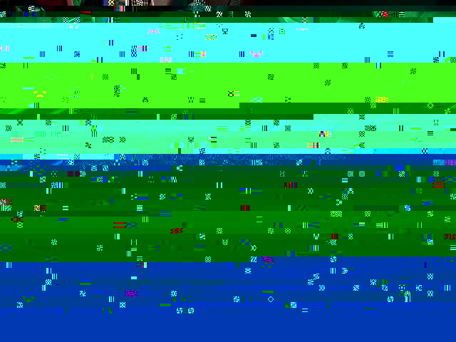

This is taking up space..What does it do and can I do without it?? thanks in advance,
Attached Thumbnails What is this and can I take it of?? {pics}-mvc-645s.jpg   What is this and can I take it of?? {pics}-mvc-646s.jpg
Old Apr 28, 2005 | 12:48 PM
Where is it located? And what year Z do you have? I don't recognize it at the moment.
I was wondering the same thing!
I think it connects vaccume lines to the cruise control. If that's all it is then you can rip it out along with the cruise.
Old Apr 28, 2005 | 12:56 PM
s/cL3.0's Avatar
Bleach is my Hero
Posts: 1,293
The cruise control is gone it hase 2 vaccum lines going into the firewall and a lot of electrical connected to it.. I have a 82 280zx N/A fully loaded the thing had every option out of the factory, including the motorola car phone...

i believe thats the vacuume control for your heeating and AC..

Yeah it's for Cruise, AC, and Heating control. My ac wan't charged and I don't need no stinking cruise control, So I ripped mine out (AC too). Looks alot cleaner without it. My heater don't work anyways, so I don't know how it will affect that. All it does is store vaccum to control vaccum operated acc. when the engine isn't producing any vaccum like when you mash the throttle.

Your heater will still work. Anything that's controled by vaccum won't work though. But mine was blowing fine, I just don't have any ducting and my fan only blows when it feels like it, so don't ever use mine. I don't know if the vents are controlled mechanically or by vacuum though. Somebody else might be able to help you there.
But the answer to your question is yes, it will still work. I wouldn't count on the ac though.

didint sombody say that thing stores vaccum so when not making any in the manifold your contorls still work...so at idle when its making vaccum it should work...controls are vaccum operated btw...i took mine off and threw it out...dun matter to me much

Yeah it's used to store vaccum.
