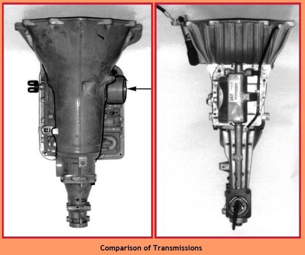

The 280ZXT Borg-Warner T5 doesn't look like the 280ZX NA tranny. The T5 should look like this:

There are some major differences between the 'Nissan/Datsun' T5 tranny and the 'Domestic' T5's used in Mustangs, Chevy's, Jeeps and numerous other US cars.
- The input shaft is shorter and has only 25 splines
- The Bellhousing is specific to the L6 (obviously)
- It's a NON-World Class (low torque) tranny - commonly referred to as NWC
- Significantly different gear ratios than domestic T5's
Here's a link to all 265 versions of the T5 that were sold to the public along with their corresponding tag #'s and the make/model car they came in:
http://www.kamikazeracing.org/dl/ZTech/BorgWarnerT5.txt
Pretty much the only thing interchangeable without modification is the shifter.
Several people on HybridZ have had World Class T5 housings converted by shortening the input shaft, converting to a 26 Ford spline count and replacing the gears with GForce hardened gear sets. Typical build runs into the $2500 range...
The good news is you can run a hi-po Ford T5 clutch with the 26 spline input shaft. WAY cheaper and WAY stronger than the Nissan T5 clutch.
