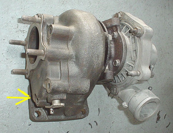

ok the back fireing is taken care of i took the tb off and clean it all up nice that made a big diff in the power but the turbo still has the exhaust leak i didnt have enough time to really get a look at it tonight but i do know exactly where it is comming from i will get pics and show you guys where it is comming from and see what you guys think is wrong

ok here is the picture i dunno if this helps any but i know that is exactly the hole where it is comming from
Old Mar 22, 2006 | 05:35 PM
Talked w/ Brady... Top 2 bolts on the wastegate housing are gone.... now we know whas up!

hey yea we fixed that one now there is another leak commin from somewhere else closer to the manifold i didnt really wanna sit outside and try to find and pin point where it is commin from because it is colder than hell out
