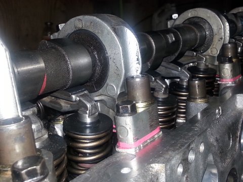

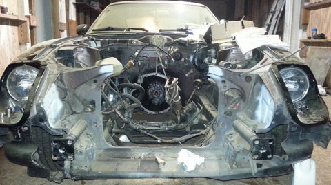

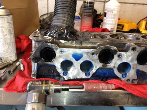

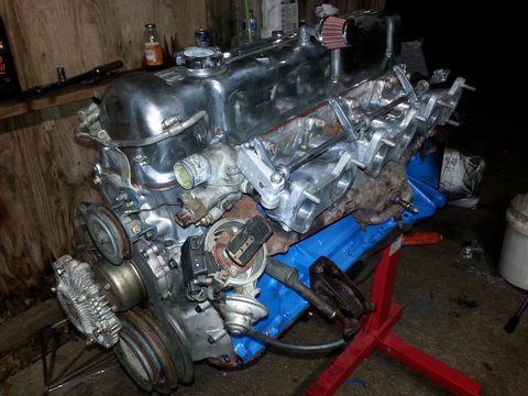

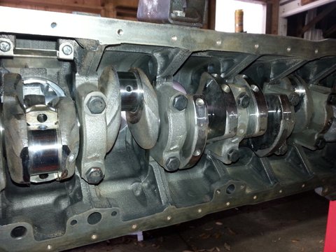

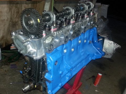

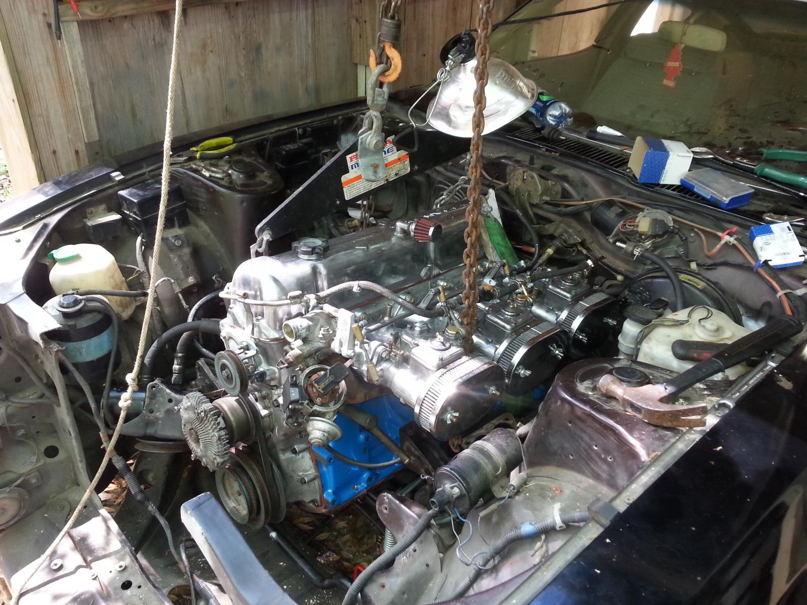

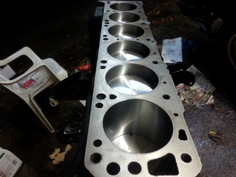

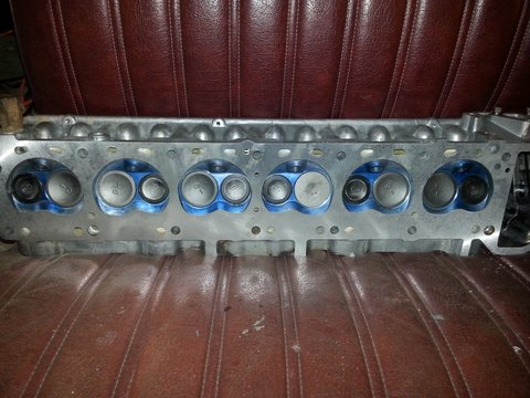

so heres my new build: f54 Rebuilt bottom end; new bearings, reconditioned crank and rods, new rings, .020 pistons, and the block was decked .005. The head P79; 3 angle valve job, one new valve, shaved .080, shimmed .080, ported and polished, mild valve unshrouding, new seals, msa valve spring kit, .260 lash pads, resurfaced rockers, and a delta regrind cam 280/270 advertised duration, and .460 lift. Running triple webers 42 DCOE 8's and msd 6al spark. i cant get my photos small enough

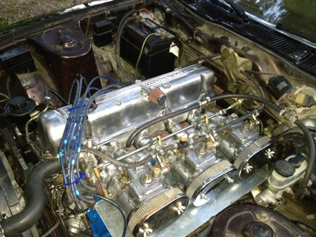

Well I got her started up now just some blanket tunning and its breakin

Looking really nice, I love the look of freshly machined metal.

Tripples
Tuning the tipples would be my biggest challenge, getting them all setup exactly the same is important I would imagine. keep us posted on getting her tuned up. I bet those pull a lot of air and sound pretty good when you put your foot in it. Add some headers and a nice exhaust system and you have pure music ! Keep up the great work

haha should just get a G37 at that point but i do covet the 370z. My s130 is up and running but i just had to tear the head off due to a faulty ITM head gasket.. never herd of them you say? yeah.. So i will be installing the FELPRO tomorrow. The power is THERE butt dyno 180 at the wheels.. Soon its off to the mustang dyno for a more scientific approach. It was seeping coolent out of the passenger side of the block. Compression is 180 psi in all cylinders (rings not broke in) and the oil had no coolant in it and the coolant has no oil in it .

I believe I'm going to go junk yardin tomorrow take some measurements and find something for a swap saw a Kia once with dual off set fans looked like it would fit I'm deleting the bumpers they are ugly. Im gunna make a fiber one front and back.
