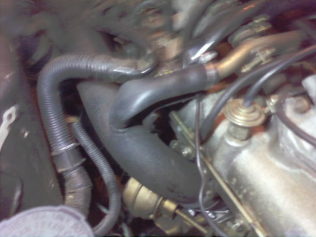

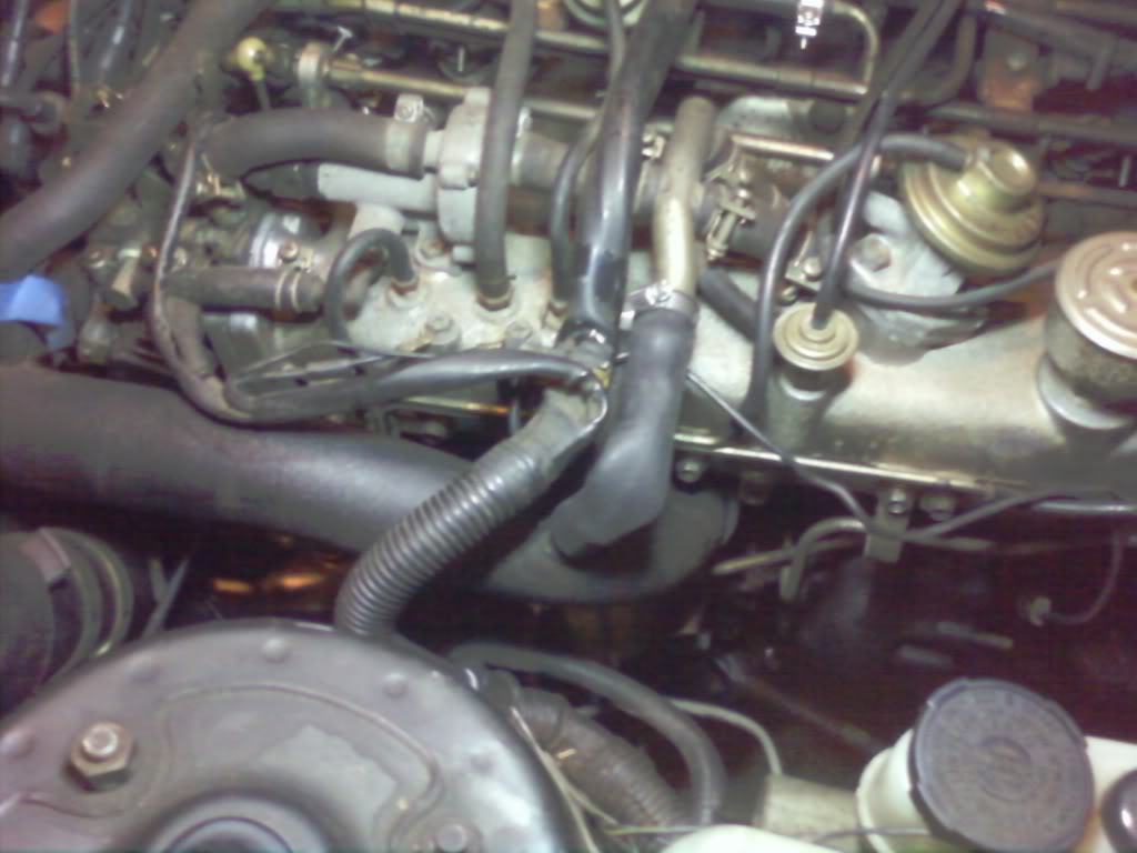

I bought a 5/8 heater hose but, it is folding. Is there a specially made hose for this?
Sorry for the bad pics, my camera blows.

use a long piece, so that it bows without kinking, or go to the junkyard and snag the formed piece.
Old Oct 11, 2009 | 05:38 PM
second ^^^
but yes there is a formed piece, you can try heating it so it morphs some. or im sure a napa can source something pre curved and the proper diameter i see pieces that would work fine if cut in my store all the time...

Cool, i will check napa out tomorrow.

you can get formed pieces at the parts store, just ask them for a few and pick one thatl fit
