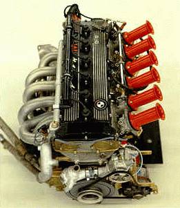

So yeah ... I'm thinking of going with ITBs on my Z, as well as adding a T3 turbo. My plan is to use RB26 ITBs mounted on custom runners, with a Volvo T3 turbo. I've been getting negative feedback from a friend of mine who is very knowledgeable with vehicles, induction setups most notably. Something to the effect that it's very complicated to do such a thing.
I think otherwise.
Trying to think logically, I've come to the conclusion that ITBs would work just as well on a forced-induction engine as it would on an N/A engine. All the main components are shared between the two setups: TPS, MAP sensor, O2 sensor, with an exception being that the MAP sensor for the boosted engine would read pressure, not just vacuum. Really, that's all one would need, no?
I want massive input on this - and please, by all means, correct me if I'm wrong on something. Thanks in advance guys.

Yeah That would take some time... I dont believe it would be the same on a turbo because ITB;s have no manifoldtheres basically a shared air filter at the end of each TB.. With a turbo obviously you would have to make some kinda box aropund the filters to get the air to the TB. and the fact that you have to tune each TB diff. to idle would be a bitch. If one is running lean it would be hard to tell then "BOOM" there goes yhat ONE cylinder, and the whole moptor.. I definetly would not do it.. Just my opinion
But if you think your capable it would be interesting to see..

^Yes, I know it's in German, and it's on an Audi L5. But take a look at the engine pics on the bottom of the page. That's what I'm going for. It's even a non-crossflow head setup, like our L-series.
s/c, you bring up a good point. However, the RB26 ITBs, to the best of my knowledge, are all directly linked with one another, so in theory there's no adjusting needed between TBs, since they should all open the same angle at the same time. But, I could be wrong. And I had already planned to build a box around the intake trumpets - that's a given.

First of all, you are obviously going to need a programmable stand-alone fuel injection setup to make the ITBs worth the time. Also, there is a company that makes ITBs specifically for L28s. I don't remember the website but if you search on www.hybridz.org you will find it. Good luck man and make sure you take lots of pictures.
I'm sure he knows he'll need a stand alone.

You don't need stand alone and you don't need a MAP sensor to make it work. What I don't think is getting relayed here is the GTR uses ITB's stock. It also uses an intake manifold just the same as the Z does. The difference lies in the fact that the skyline has a throttle plate in each of it's runners and not throttle plate in the opening to the intake manifold. So the easiest way to do this is to find a known size of a throttle plate and fabricate a set of runners that could house those throttle plates. Then you would have to link them all together so they would open simultaneously.
Also of note is the fact that the Skyline uses a MAF. That's right. It doesn't even use a MAP sensor stock. The reason so many have a MAP sensor is because when the switch is made to single turbo (which is often) only of the MAF sensors would be working and well that just wouldn't work out. So you don't need to change anything as far as engine control is concerned to make the ITB's work. And if you go the route of how the GTR's manifold is set up then it's VERY feasible with this car. What this will do for you is increase throttle response greatly. And since you can still control runner length and manifold volume you can still control where the powerband will be. If you or someone you know has any skill with a welder and a tape measure then this project isn't as complicated as you might think. But it is precise and error won't turn out nicely. Everyone is so used to the filter or air horn at the end of the ITB's that's so common, I thought I should clear that up.
Oh and by the way, I'm not saying don't use stand alone. You would see even greater benefit from the ITB's with the tuning of a stand alone. I'm just saying you don't NEED it

Okay, so here's what I'm going to do - I'll start simple, by re-using the stock computer with a rising-rate fuel pressure regulator. The TPS won't take but 5 minutes to get in the right place and accurately working. AFM will be placed where it is stock.
Hell, I might just do the ITB thing before I get the turbo. I'll run it that way to work out the kinks, then add boost to the equation.

I've decided to skip the N/A temp build, and go full turbo ITB. An acquaintance of mine on HybridZ.org will take a Q45 TB and $50 in trade for his RB26 ITBs, so technically, I'm getting them for $100. Turbo's $200 from a friend, and welding supplies kindly sold by my good friends at Harbor Freight Tools.
I'm psyched!
