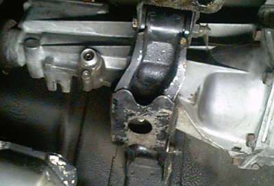

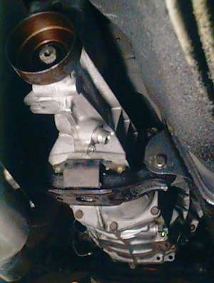

Here is the crossmember. You unbolt it at each side. One large bolt on each side. You can also unbolt the center bolt up inside the circle in the middle of the crossmember. If you do that, then lift and push the tranny forward. this can sometimes be difficult.
Here you can see the single bolt going down from the mount. this is why you have to lift the transmission if you only unbolt the center bolt. I suggest just unbolting the whole rear mount crossmember from the car.
Another view of the crossmember. note in this pic the driveshaft was already out. It was unbolted from the diff first.
ya, that's a T5 not a Nissan transmission but the mounts are identical.
