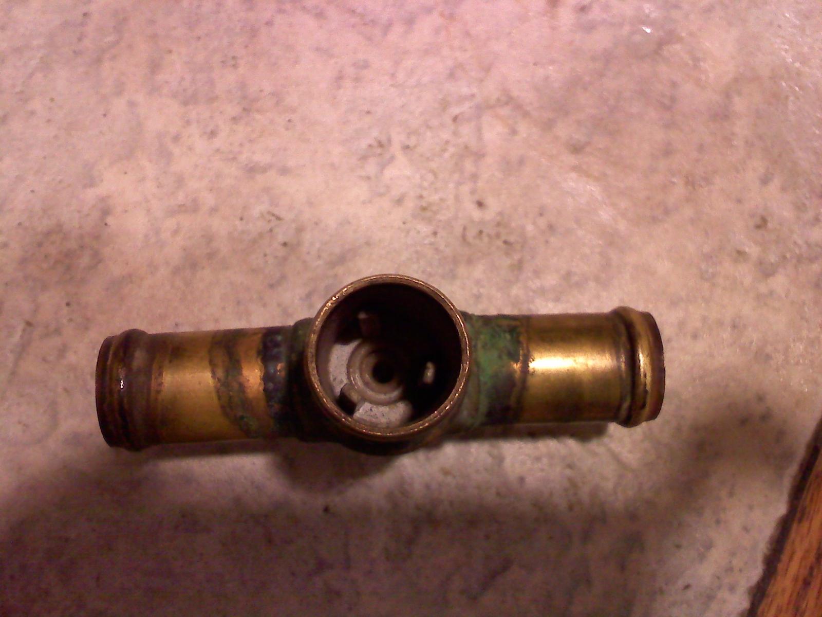

hi folks i am a new owner of a 1979 280zx the heater lines have been cut and pluged and as i suspected the heater core leaks . my question is this there is a brass tee on one line that has like a t stat in it there is no hose comming off it and i have no idea where it would lead to any help would be appreciated as to what this is and where the heater hoses go to thanks

there are two hoses from fire wall one has a 90 degree turning down to the plug put into the block the other hose runs along the engine to the water pump that it the hose that has the tee the tee is actualy upside down so the hose has a straight shot from the water pump the tee points stright up with the t stat or dump valve but no hose was atached to it

i took the tee out here are the pics. i think i have std. ac i see at the z store the the control for me is not avalible i wish i could see a pic of mine it looks like a hose ataches to the top of the control valve

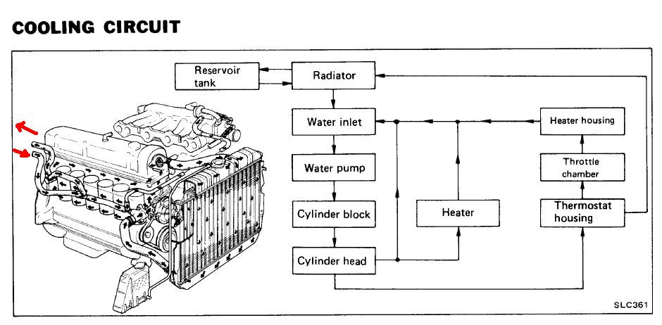

Here ya go... From the FSM you can download from the link I posted.

looking at this picture. the tee mecinsim looks like it sits in the middle. it also looks like it ties back in where it goes into the block. right now there is just a plug in the block i will need to find that y that mounts into the block any ideas

are you refering to the "T" that's been circled?

yes the tee ibelive is circled in reality its a littel closer to the left. as far a junk yards we have a couple i hope they are open tomarrow. i just got the car saturday. i will let you know if i cant find one here locally. thank you soooo much for all your help
