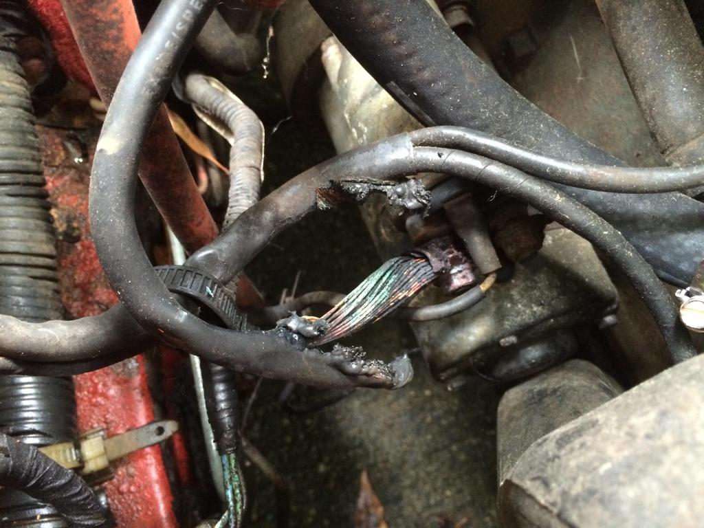

I bought the car and it would not start. I would crank it and the starter would try work, so I check the battery cables and found this:
The two wires that the casing is melted are the injector fan and maybe the oil temp sensor?? I tried to find the injector fan in FSM to confirm, but to no avail. Is it called something else? Plastic Turbo came up with no results too.

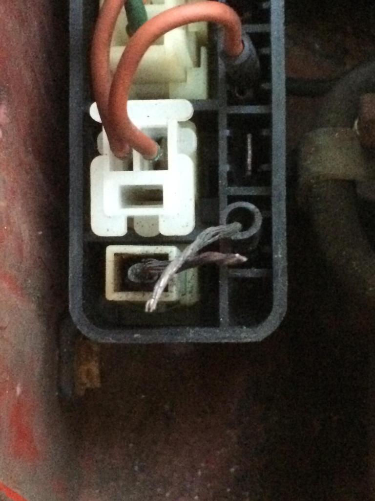

I replaced the battery cables, charged the battery, and replace the starter. After I did that, the starter worked, but it would not turnover. I notice I did not hear the fuel pump kick on when the key was in the on position. I pulled up the FSM and started to see if the how the fuel pump was connected. I check the fusible links and they are kind of confusing, but none seemed burnt. Can you tell me if I labeled them correctly?:
What is the one labeled Awesome Source for?

So I did a little more digging and forum searching and came across a post where some one said that the fusible link connectors could look okay, but actually be burnt. I went back and rechecked them a little more closely and this is what I found:

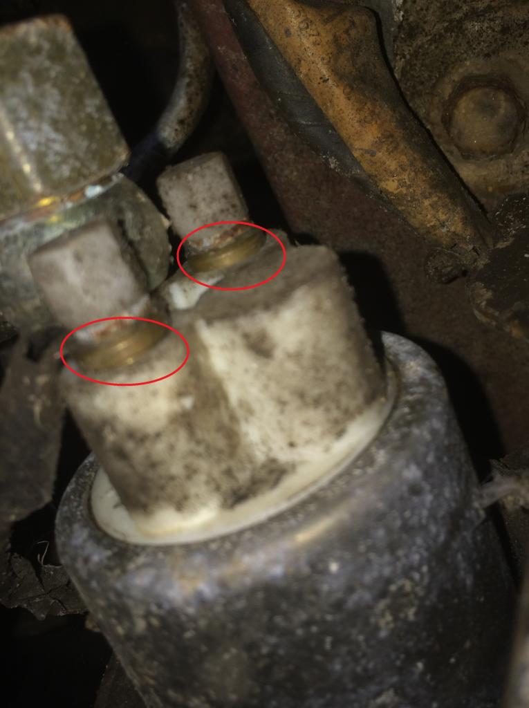

I wanted to check to see if the fuel pump was getting power, so I twisted them together and used a volt meter to make sure that power was still flowing. I checked the fuel pump with the key in the on position and in the off position. These are the connectors (red circles) I use to check, it did not show that it had power.
Even if the fuel pump is bad, shouldn't it still show power going to those connectors? I am going to take the fusible link box out of my parts car and install it in this one.
