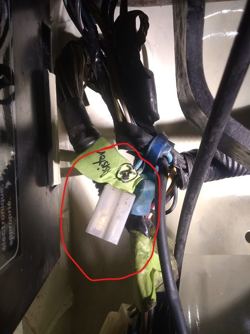

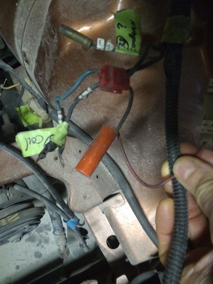

I purchased an 1981 that was completely disassembled. I have the manual and it's great for guiding me through a stock rebuild.
My ignition wiring doesn't look like it's original, but I think it's it's all there except the coil.
Does anyone have this Chapman part and condenser? (This is my first Z, and I'm not an electrical guy)

More interesting than I expected; its a car alarm!
I think that the Chapman unit is part of an old security system. That would explain why there are so many strange splices under the hood.
Next is to follow the manual and see if I can get it back to stock.

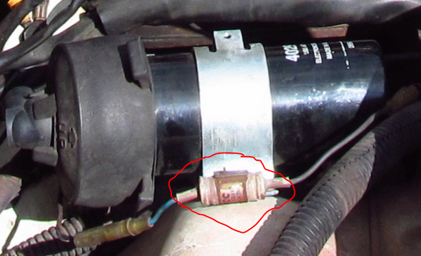

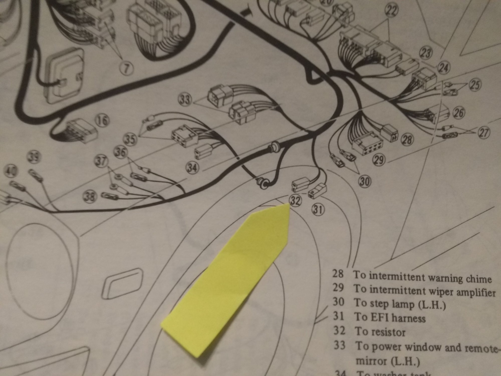

I don't have the little condenser on the side of the coil. Is that necessary? Also, I don't have the Resistor shown in the FSM, #32. That piece didn't come with the car.
Does anybody have a picture of what the resistor looks like? It's between the the clutch and the computer.
