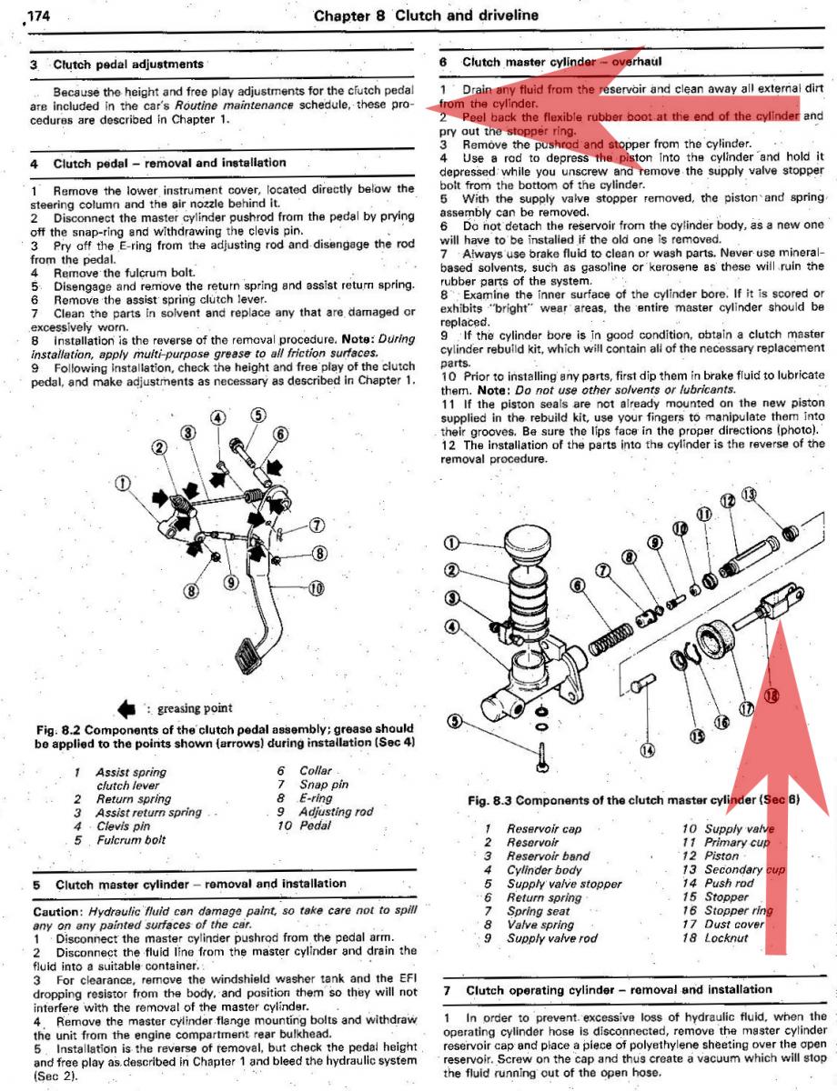

This is what I found in my manual (arrows added for emph-***-sis)...

what in the hell service manual is that then? cuz that definitely wasnt in mine, and I have 3 different ones
Old May 28, 2012 | 03:56 AM
It looks like the Haynes repair manual. I am real familiar with those. But it should be in your FSM also. Which I have an FSM for all my 280zx's
