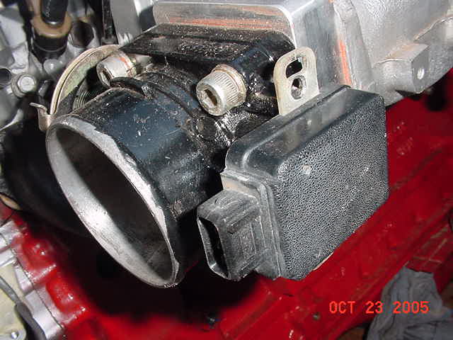

Alright I attached some pics. The first pic is of the entire hose routed around the TB.
The other two pics are where the hose begins and terminates. The one is right next to the TB. The other is right near the Air Regulator.

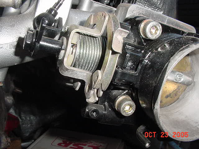

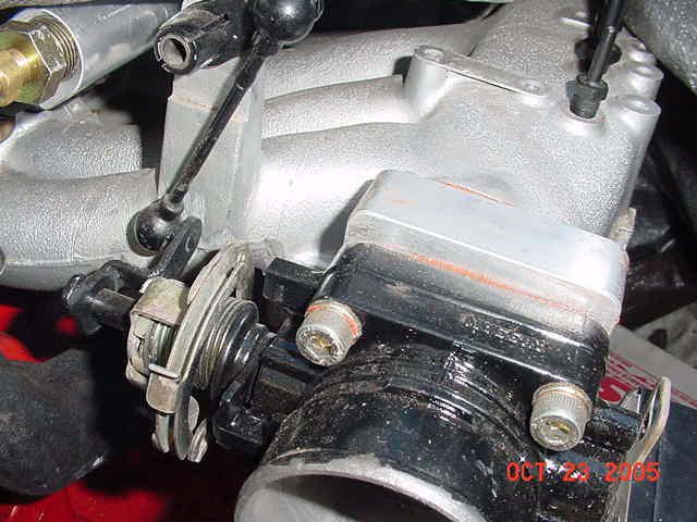

Here are the pics of what I did.. Hope it helps

ok. The third picture from left to right. That box with the plug, in the inside, its different when i compare it to the one of the 240sx.

Yeah you gotta use the one off of the 280ZX and just re drill the holes.. pain in the *** if you dont have a clamp or drill press

ok. What i mean is that that piece that is in the 3rd picture. On my 280 Tb, there was an axle that came out of the tb and get in that part. The 240 Tb, don't have that axle hat goes inside that.

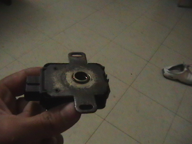

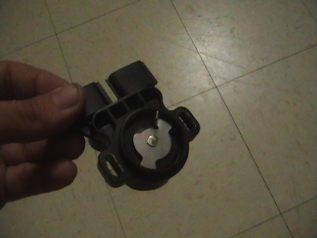

ok, i allready put together the 240Tb. Thanks for the pics. Now look at this pictures. The one in the leftis of the 240 linkage, and the one in the right the 280. As you can see there's a hole in the 280, that is not in the 240. how am i suppose to addapt that?

WOW. that doesn't look anything like the TPS on the 240SX TB I put on. That must be a later style. What year motor did the TB come off of? That definitely wont work with the 280. It's a TPSensor. The 280zx uses a TPSwitch. They are not interchangeable. If you want to keep the TPS you're definitely either gonna need to go source another shaft from a 240sx at a junkyard (try to find an early S13) or see if the 280SX shaft will fit the 240 TB. That'd be the easiest way. When I had mine it looked like the shaft would fit but I didn't get a chance to try it cause I stripped the screws in the TB shaft/plate. See if the 280 shaft will fit first and let us know how that goes.

He did post the pics of the TPS and the connector is not compatible with the 280ZX's male connector. The TPS he has is not a switch like that on the 280ZX and early 240ZX's. It'a sensor and can actually account for the entire rotation of the throttle shaft. Efrain, if you run your car without the TPS you're not likely to notice much of anything. I do it all the time (not on purpose) as mentioned above. Your not going to do any damage not running your TPS. On some cars that absolutely require that signal it would make a differance. But I'm telling you from experience, the difference on the 280 is so negligable I have never noticed it.
I would try unbolting the throttle plate from the TB's and pulling the shaft out and seeing if the 280 shaft will clear the 240TB. If it does then it's problem solved. If it doesn't then you either need to run without TPS or try to get your money back and find another TB.
