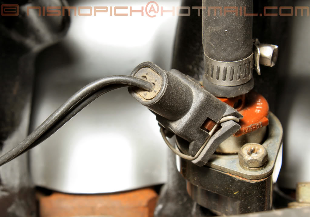

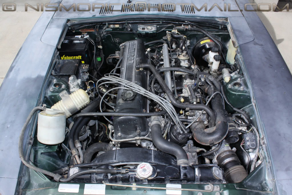

From my 280zt swap:

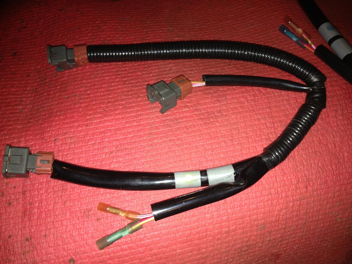

Here is one of the two harnesses
Attached Thumbnails 91 Maxima infector Harness into S130-maxima-inj-harn-sm.jpg
Old Feb 25, 2012 | 09:40 AM
garretthes's Avatar
Joined: Oct 2010
Posts: 98
OK how do I know which wires to connect of the pair? There are two wires with the new harness. One is thick with a stripe, the other is smaller. The original harness has two small black wires. Does it even matter?
Old Feb 25, 2012 | 10:32 AM
Cut the wires on the new harness about 3" to 4" back from each connector, then cut the old connectors on your car about 2" to 3" back from the plug (so you have an inch to work with on splicing).
Connect new plugs with same polarity as orig ones... done.
