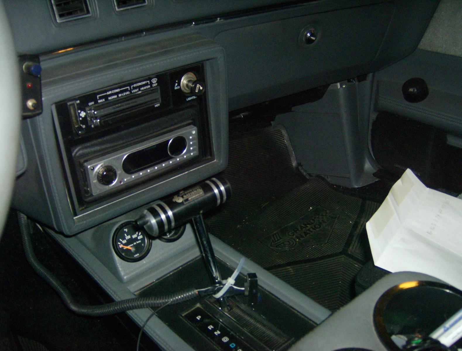

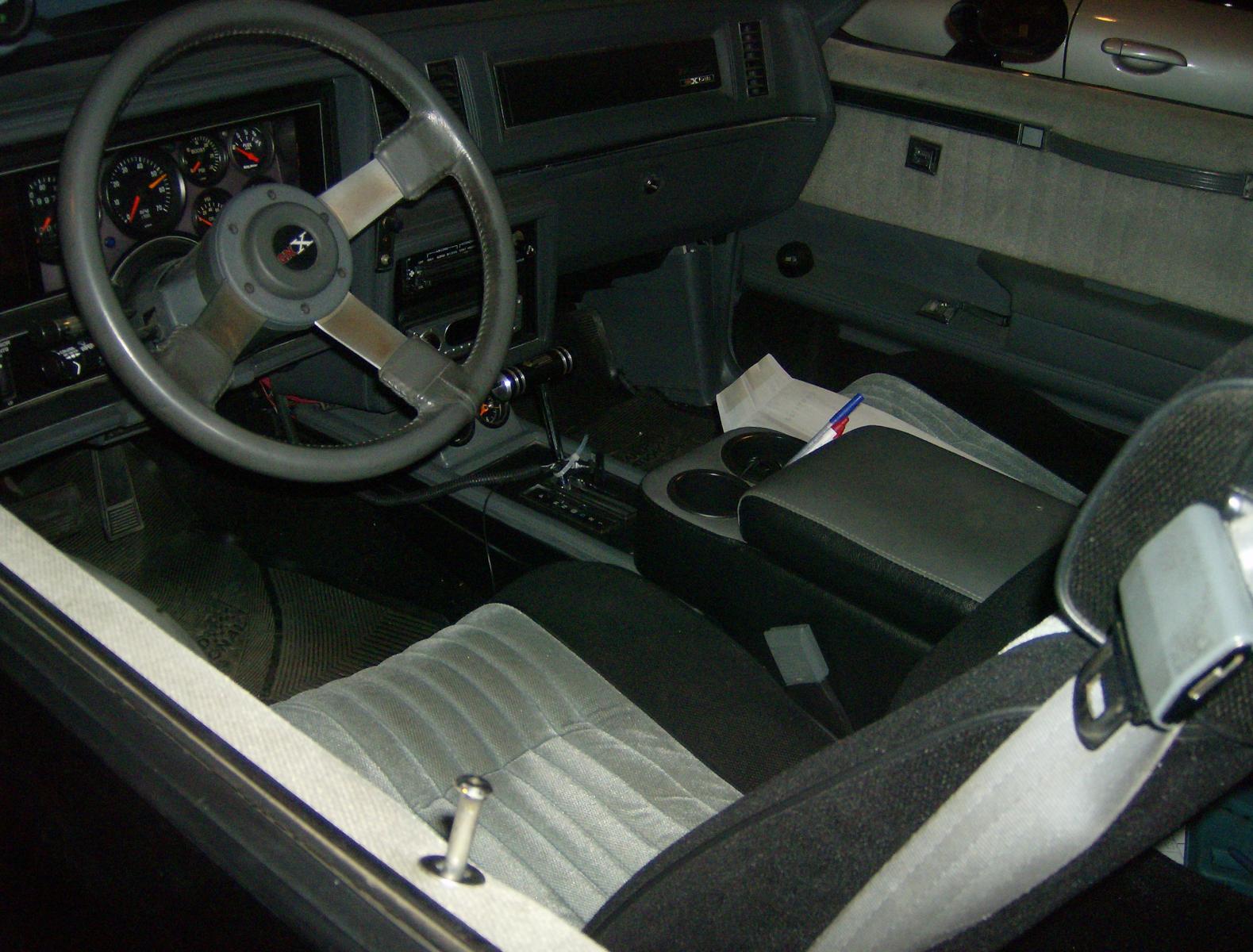

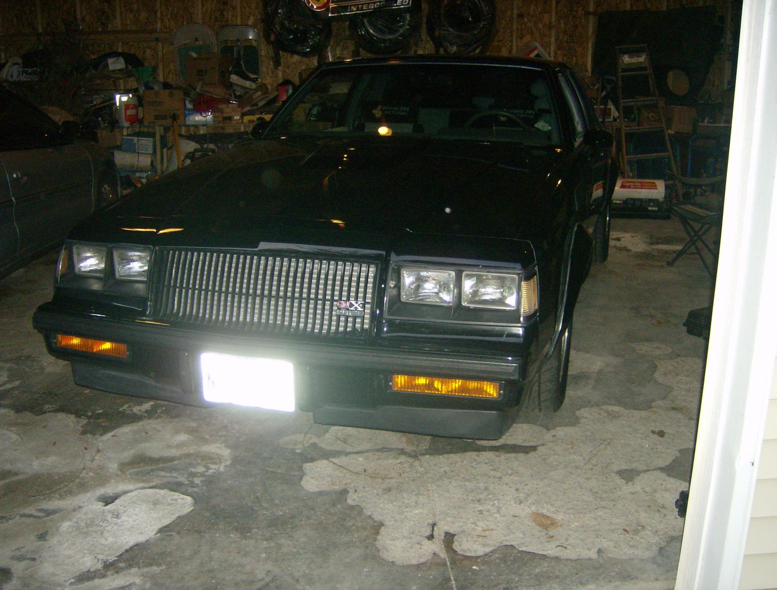

I just looked in Haynes and couldn't find it. Must have been in the owner's manual. I know I just read it a couple days ago.
Attached Thumbnails 83 280zxt cant rev up.-hpim2634.jpg   83 280zxt cant rev up.-hpim2638.jpg   83 280zxt cant rev up.-hpim2642.jpg   83 280zxt cant rev up.-hpim2641.jpg   83 280zxt cant rev up.-hpim2646.jpg
