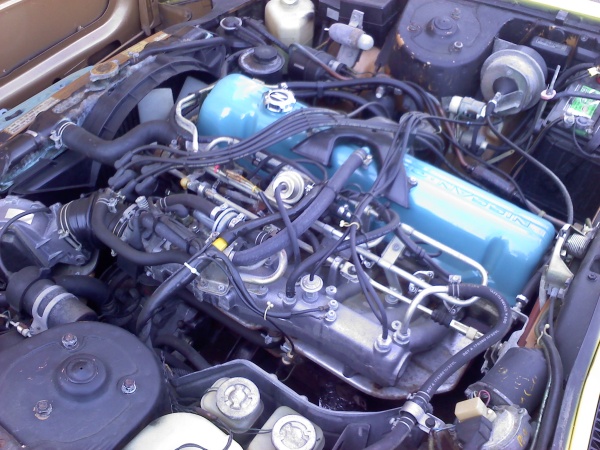

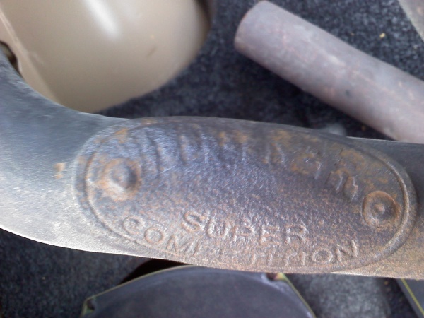

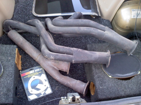

Ok, so on an impulse buy I snatched up a of Hooker Super Comp header for cheap. Plan to get it powder or heat coated, and port matching it before putting it on the car. The guy had it on a 78 280z L28 N/A. He told me it should work just fine on my 80 280zx, but I might have to notch the driver side motor mount to clear one pipe. Wondering if anybody out there has been this route and might offer some advice?
Also, should I got ahead and buy the motorsport auto gasket, stud and nut kit, and will I need the spacers? I think I remember him saying something about that.

All L-Series motors (L24, L26, L28E, L28ET) used the same motor mounts... so if the header fit with the motor mounts on a 78 L28E, it will also fit on an 80 L28E, unless he had to notch his to make it fit.

it most likely won't work on your car at all
I've got a header from a S30 (280Z) and it fits like crap, I had to cut and weld the three rear tubes farther back to clear the steering arm.

^^^ ah, you have the steering box (his 80 looks to have one too)... Indeed that would get in the way. Shouldn't be a prob w/ rack & pinion though.

I did some rough measurements and it looks like the header should clear the steering box by at least an inch? 8 1/8 flange to outer pipe 9 1/4 from head to gear box. I have a running 83 that I am parting out, if I could find someone to buy the motor and trans out of it, I could swap the rack, and whatever else onto my car if need be. But I am going to try to make this work. If not I guess it will be up for trade for a correct header after it gets ceramic coated.
I need to do something, my exhaust is currently tack welded onto the manifold.. LOL
Pontiac Kid, how much did you have to add on the rear collector to make it work>?
I did some research and just need somebody to help confirm this. My cylinder head is a N47, and from what I have collected, it has diamond (round) exhaust ports. So I am thinking this header will not work, it is square port.

I've got rack and pinion. a real sports car with manual steering
the problem is the steering arm doesn't stay close to the frame rail and cuts into the bay quite a bit.
just save yourself all the bullshit and get a header built for your car.

Haven't had a chance on shipping. It's square port for sure. You'd need an N42 or P90 to run it.
Old Apr 11, 2011 | 08:03 AM
you can put a square port on a round port head, just not the other way round. i have round ports > p79

The flow would be obstructed, would it not? I don't know if I could port match them or not. Maybe with a grinding stone and the dremel?
